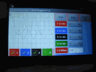

i did a mini oszilloscope for android and on a wifi port ( like angus spoken )
i will try to use your project in my simple doings - very very welcome!

Sorry for the late reply. Yes it was hard coded to 10kHz as I used a high performance timer to collect data. I could not get it to run faster with this technique. A much better way to do this is by using DMA and i2s.
It does not require the Wrover kit, but is then limited to 10kHz. The Rigol DS emulation over wifi also is a bit unstable. Most of the times it works but I have a feeling that the huge amounts of interrupts maybe makes the network code drop some packets.
https://twitter.com/ESP32net/status/958438631949111298
