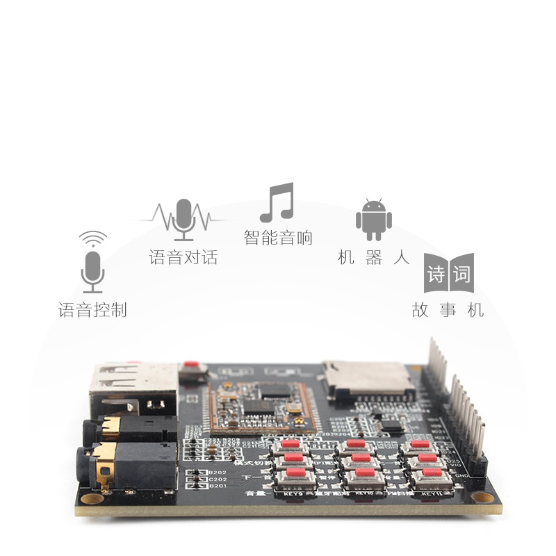

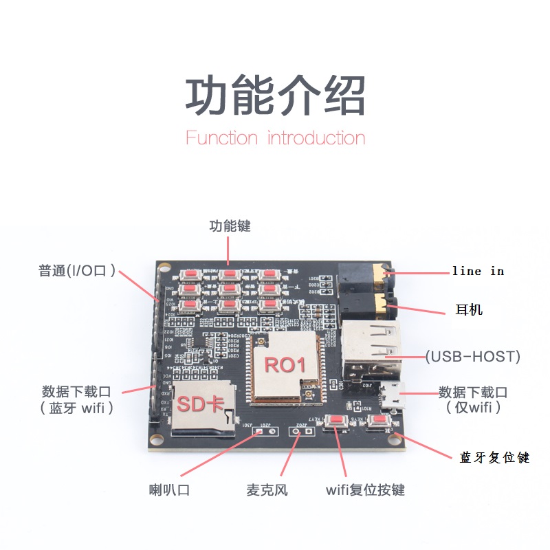

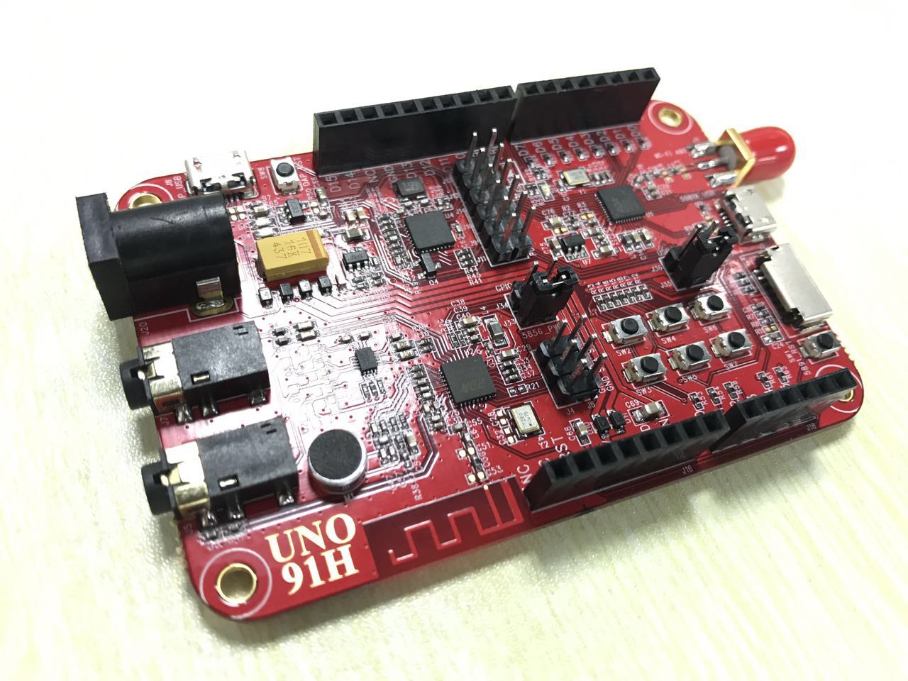

but now, ... it seems like lyra is getting a competitor now.
other version:
..and not only lyra, this RDA5x series it's damned serious to take.
