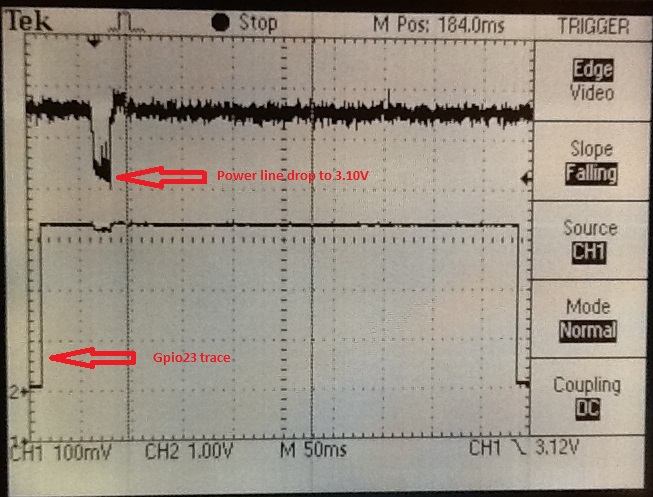

Hello, I'm sorry to ask this question again, as I've been reading about this topic in the forum already for a while, but I'm just stuck right now.
I'm porting a project from the esp12e to the esp32, using the following: I'm trying to enable Wifi and observe that when the code calls esp_wifi_start() this trips the brownout detector and restarts the module. I've tried the wifi scan example code, and it does the same. So pretty sure it's not the code.
The last logs printed before restart are:
I (89) wifi: wifi firmware version: ebd3e5d
I (89) wwifi: config NVS flash: enabled
I (89) wifi: config nano formating: disabled
I (89) system_api: Base MAC address is not set, read default base MAC address from BLK0 of EFUSE
I (99) system_api: Base MAC address is not set, read default base MAC address from BLK0 of EFUSE
I (129) wifi: Initt dynamic tx buffer num: 32
I (129) wifi: Init data frame dynamic rx buffer num: 32
I (129) wifi: Init management frame dynamic rx buffer num: 32
I (129) wifi: wifi driver task: 3ffc031c, prio:23, stack:4096
I (139) wifi: Init static rx buffer num: 10
I (139) wifi: Init dynamic rx buffer num: 32
I (139) wifi: wifi power manager task: 0x3ffc4f5c prio: 21 stack: 2560
W (149) phy_init: failed to load RF calibration data (0x1102), falling bacck to fullcalibration
Brownout detector was triggered
I've read here in this forum that enabling wifi, and specifically doing full calibration uses a lot of current (upto 500mA), so I suspect that I have some power issue here.
Here's why I'm stuck.
I've hooked up a scope and traced the power line on pin2.
When the module is idling (ie: waiting for download), I measure 3.26V.
When I start my test code (bootup; reset gpio23, wait for 10s; enable gpio23; try to enable wifi). I can see there is a small dip on the power line but only to about 3.10V for ~20ms. (See attached jpg).
Note: I used a gpio23 pin to drive a LED on ch2, and enable it just before calling esp_wifi_start().
But if setup a single mode falling edge trigger for 3.00V, it never fires.
The brownout level is configured at the default 2.43V.

See the trace below.

Are you sure the timebase of your measurement is correct? Calibration tends to give very quick spikes of power use; if your timebase is incorrect you may miss those. Also, what does your wiring look like? If you have a breadboard and breadboard wires between the ESP32 and power supply, these may have too large a resistance/impedance to feed the ESP32 power when these spikes happen.

Postby J00003 » Mon Mar 05, 2018 2:24 am
scope trace 1
Above is the scope trace that I referred too, so you can see the timeline.
The trace's timebase is course (@ 50ms/div) to show how long the gpio pin (ch2) is high. It is enabled right before the call to esp_wifi_start(), and reset to low, on test code startup. I am using this as a reference to see when the start function is called.
The wiring is as follows:
- breadboard supply has pins that plug directly into the power rails of the breadboard
- using jumper wires from the power rail to pin 2 and from the ground rail to the GND pin (next to pin 37) of the seeed board
- scope probe connected to the +ve lead of the 10uF cap solder directly to the seeed breakout board. (I left a short 3mm pigtail on the bottom of the cap for the probe).
The scope is not top-notch, but still pretty good at 60MHz. I try to capture something with the trigger level at 3.00V and 5ns. But no trigger after many attempts. (over 20).
I have the probe connect on the cap, as noted above, avoiding all the resistance, and other artifacts from the breadboard.
Does this seem reasonable?

- I understand your explanation regarding the cap recharging, etc, but the scope trace doesn't show anywhere near the voltage drop to trigger the BOD at 2.43V. If the scope showed a significant drop, I could understand why BOD is tripping.

So, I have solved the problem. I believe that there was some kind of grounding issue.
As mentioned above, I had grounded the Seeed breakout board from the gnd pin on the bottom of the board, ie: beside pin #37 to my bottom breadboard rail. Now, in addition to that ground, I have also connected pin 1 on the Seeed breakout board to the top ground rail of my breadboard. This is working as I hoped, ie: can start Wifi without BOD.
This does make some sense as this is were I have the cap wired in, ie: across pin 1 & 2.
But, if I remove the cap, it still works properly, which is not what I expected.
I also did another trace with the scope, and found that the power dip is a little more (down to ~2.90V, roughly 200mV more than before), but the BOD does not trip.
Thanks for the help, hopefully someone else finds this post useful.
