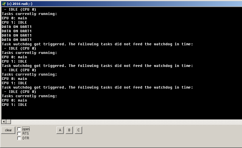

hi guys
not sure - have not read yet ( not searched in detail ) -
have someone knowledge how we can feed watchdog for CPU 0 ?
can we clear / read / set this register ?
Task watchdog got triggered. The following tasks did not feed the watchdog in time:<\r><\n>
 - IDLE (CPU 0)<\r><\n>
Tasks currently running:<\r><\n>
CPU 0: main<\r><\n>
CPU 1: IDLE<\r><\n>
CPU 0: main<\r><\n>
CPU 1: IDLE<\r><\n>
thanks

Looks like there's an esp_task_wdt_feed() function in ESP-IDF that looks like it will feed FreeRTOS's watchdog implementation.
Implementation is here, see the related header for maybe more information:
https://github.com/espressif/esp-idf/bl ... _wdt.c#L94
Have not tested this, however.

That would work if you want the watchdog also to watch the tread calling the feed function. To get rid of this specific message, it's enough to write a task that does not take 100% cpu time (e.g. by yielding to FreeRTOS by doing a vTaskDelay every now and then.)
