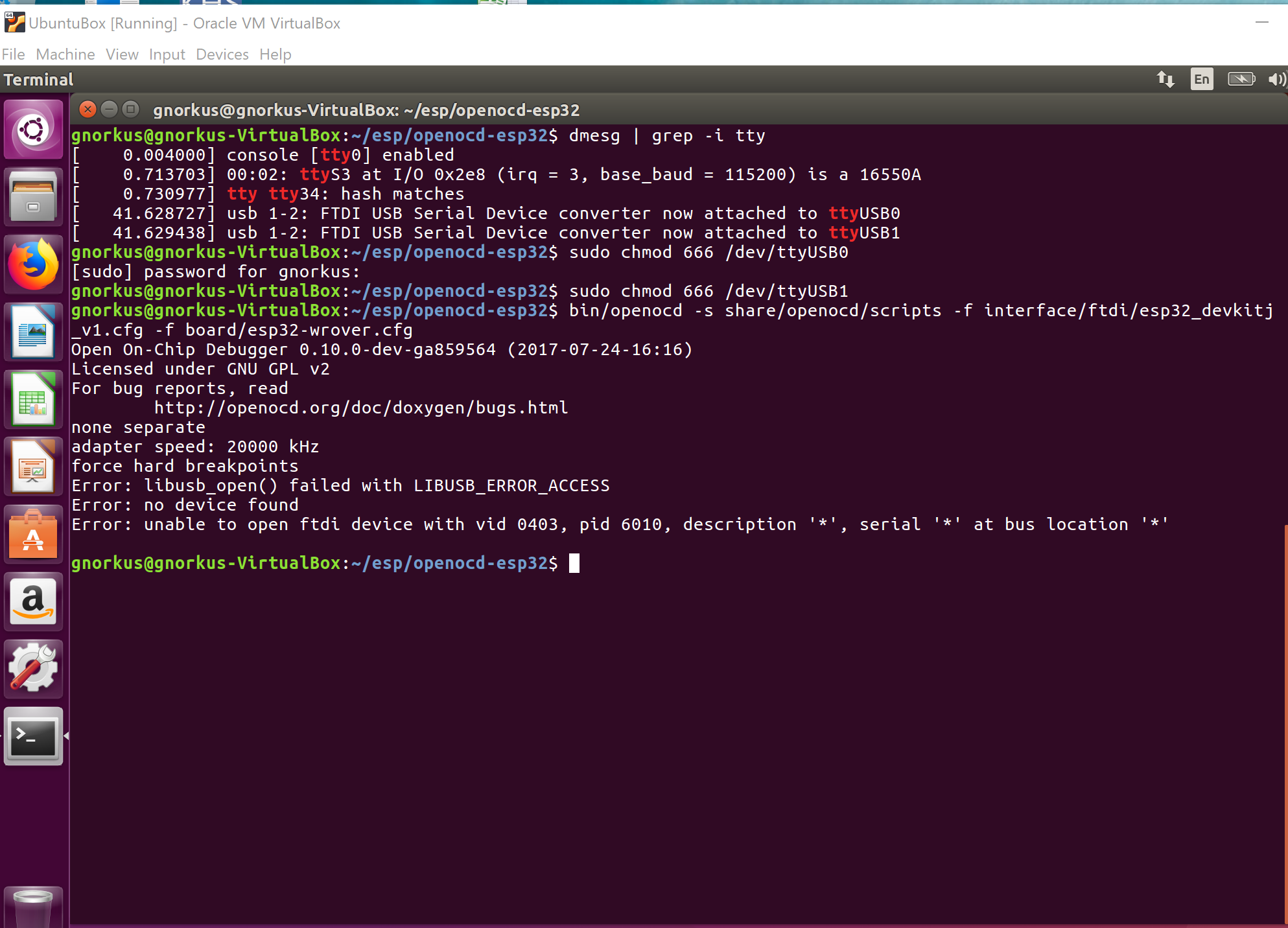

Well. I figured out my woes regarding USB in Ubuntu.
Wireshark, WinPCAP, and USBCap.
Removed them from the system, and a sliver of joy has returned to Delaware (at least my neck of it). Although it is not yet complete.
1. I successfully can flash the SparkFun ESP32 Thing (yayyyy!!!!)
2. I successfully can flash the ESP32-devkitj (yayyyy!!!!)
3. OpenOCD fails because libusb cannot see the USB device (BOOO!!!!)
Now, I'm plugging in the WRover devkit (v3), I do a dmesg | grep -i tty and here's the output, plus the failure. What will I need for openocd???

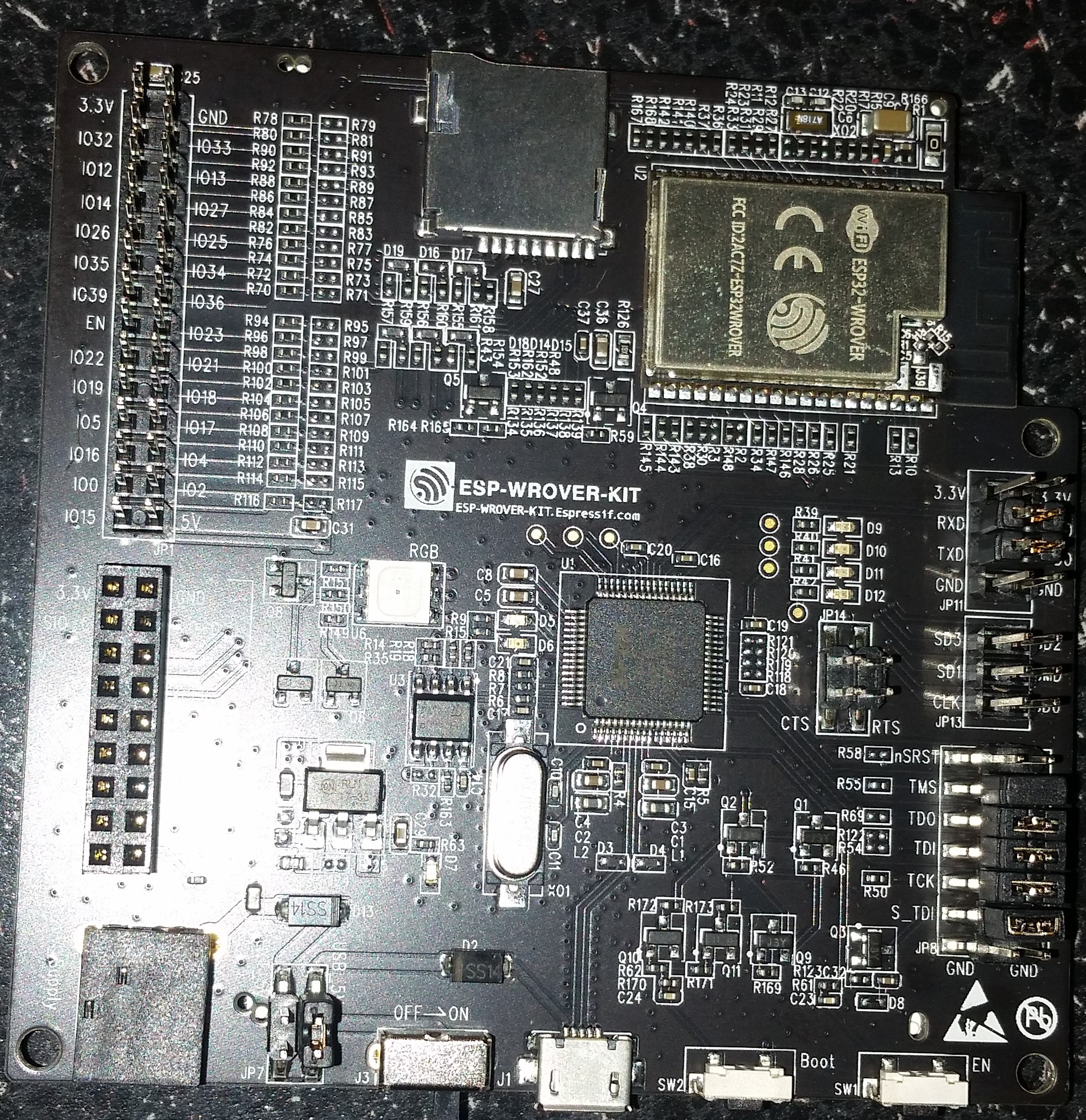

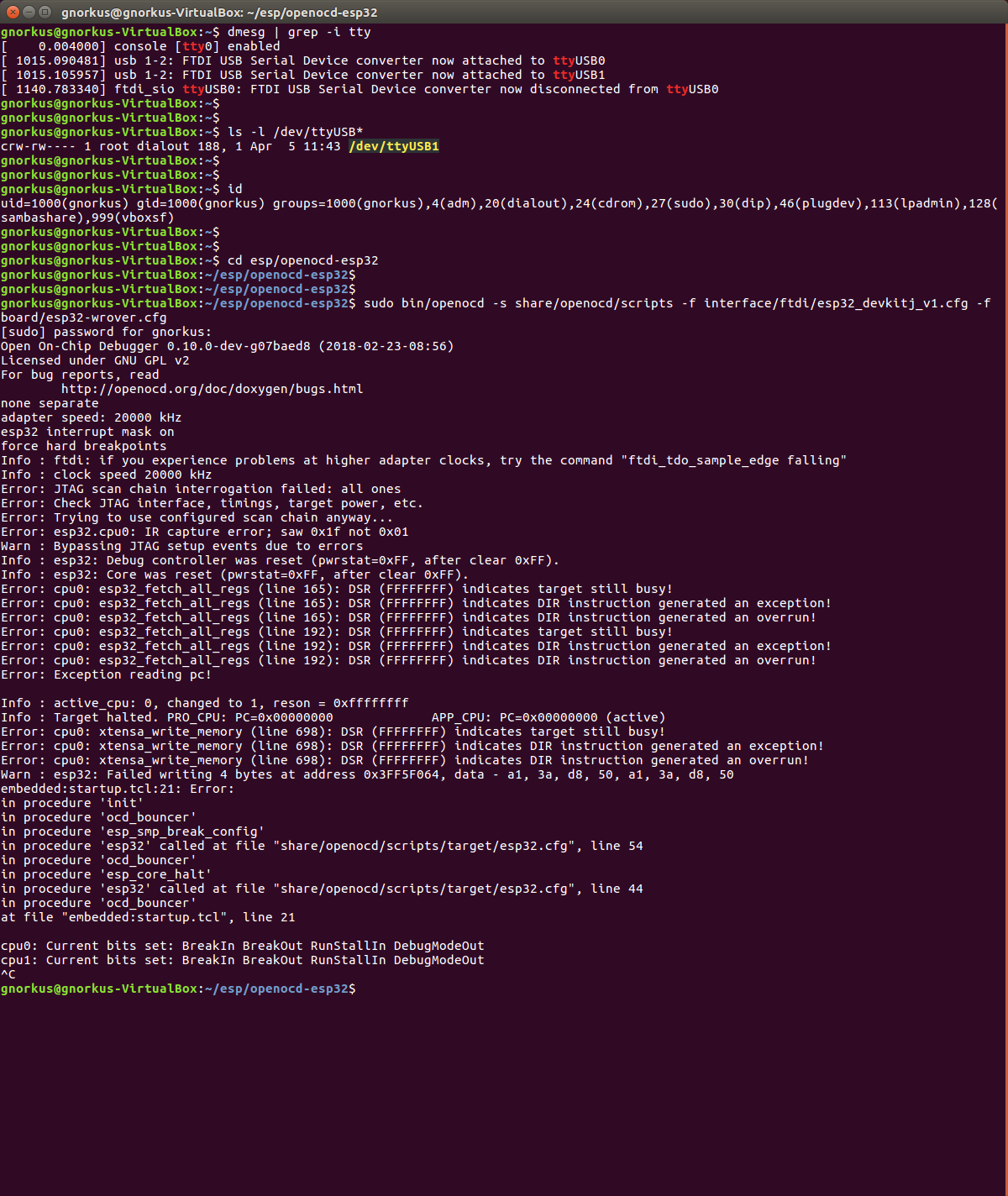

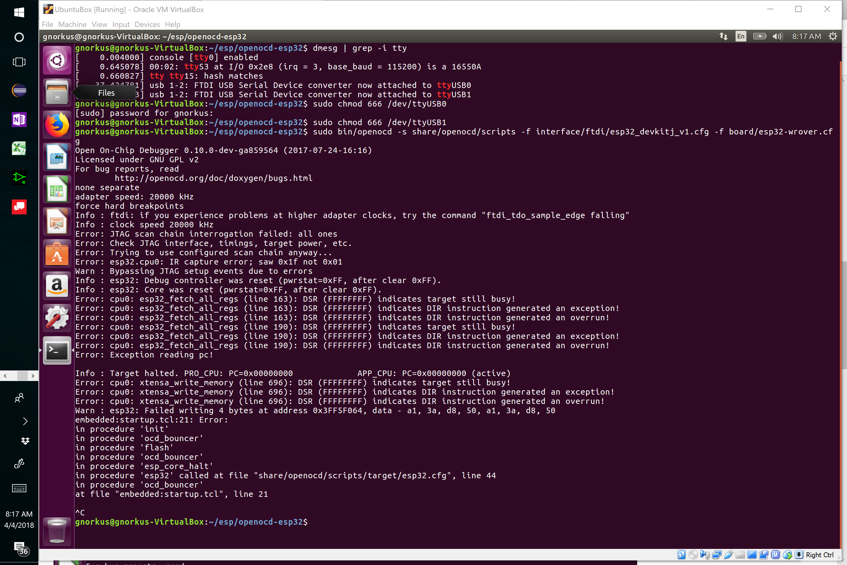

I did read Neil's section on setting up the jtag on the WRover dev-kit. Attached is a picture of my setup.
1. I do a make menuconfig and change the flash to /dev/ttyUSB1
2. I plug in the device, use the menu entry 'Device' to capture both USB interfaces in the Virtual Box
3. I dmesg | grep -I tty to see the dump of the connections. Both interfaces for the WRover kit are there
4. I 'sudo chmod 666' both interfaces to give permission to use them.
5. (I am able to successfully build hello_world and flash it to the ttyUSB1 and monitor the messages)
6. I try the sudo bin/openocd method and...no joy I've attached a picture of my board jumper setup.
I'm reaaaaallll close, I think.
Output of some of the above commands
Setup of jumpers (see lower right)

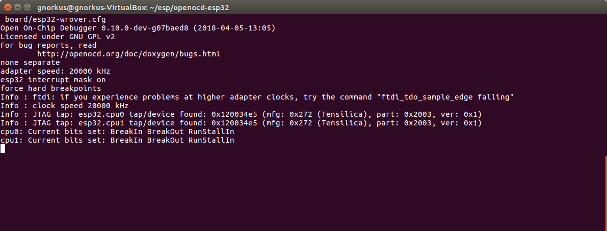

Re: WRover-Kit Attach to Ubuntu 16.04LTS VirtualBox
In my environment, I am running Windows 10, Virtual Box, Ubuntu. I do all my development in Ubuntu ... so we seem similar/same there. I am running a WROVER-DevKit ... just like you. One distinction is that I do NOT have a jumper on the S_TDI pin which your picture shows you do ... otherwise jumpers are same.
I startup open-ocd ... it starts and pauses at the end. I then open up gdb using the "recipe" and it all "just works".
Try with the S_TDI jumper removed. If no improvements occur, we can try and find a mutual time to do a screen share and/or I'll go through my recipe slowly and maybe create a video.
SOLVED
And I wish that Espressif would pay me the roughly $2k of time it took to figure it out, but I'd settle if they shipped me 100 of the WRover modules.
Neil, they owe you too!!!
It turns out I had a defective board. There was a ground short UNDERNEATH the ESP32-WRover module. How was this determined...
1. Figured it might be a problem with the jtag pins, so ground to pin continuity was checked on the TMS TDO TDK and TCK pins of J8 (the pins closer to the inside of the board). Continuity was detected at TCK pin. 0.4 ohms.
2. Removed R50. It was indeed a 10k 0402 resistor as per schematic. Checked both of the pads for continuity to ground, and both were grounding.
3. Traced line back to IO13 on the WRover module. Determined that it's neighboring pin was a ground pin, so removed R37. Once removed, only one of the R50 pads was now having continuity to ground.
4. Removed WRover Module from board using hot air rework tool. Discovered this board was actually designed to use WRoom or WRover, and that a couple of the pads for the WRoom were shorted by a solder blob. Those pads connected to ground and IO13 on the WRover module.
5. Soldered on new WRover module. Joy again in ESP32 land.
6. Will never take for granted that the factory did their QA inspection.
