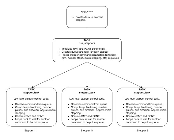

There are several tasks in my program. Here is a jpg image describing my task architecture.
The abs_stepper_run function is called in the run_steppers task.
When I comment out the abs_stepper_run calls, the code works normally - all the messages are printed, but of course the stepper code is not run.
I suspect I am missing some basic knowledge about tasks / FreeRTOS / low level ESP32 stuff, because it doesn't seem possible to me that the app is behaving the way it is.
Without commenting out the abs_stepper_run calls, I can see that abs_stepper_run is returning. Otherwise the "1st command sent" message would not be printed. Also, I am printing out a message after the stepper_task processes the command it receives from the queue and right before it returns to get another command. So I know the stepper_task is not hanging.
