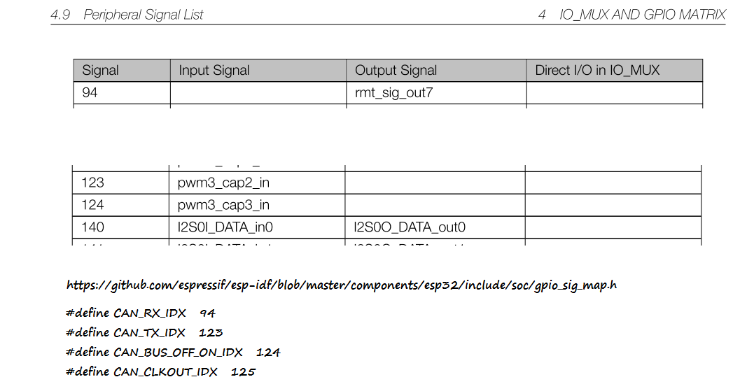

Re: UART on any GPIO or not
hi Angus,The technical reference manual Chapter 4 explains the GPIO Matrix & IOMUX in detail: http://espressif.com/en/support/download/documents
Angus
do you know, will the reference updated with this ?
txs
rudi
I think probably not until we release more details about the CAN controller.do you know, will the reference updated with this ?
