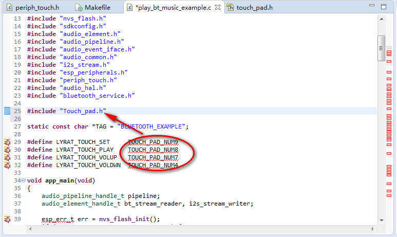

so everytime when we include a file in the project , we also need to add the PATH in the eclipse option setting ?
anyway , why i have add all path , there is also a error happen====> Symbol 'TOUCH_PAD_NUM9' could not be resolved

The C programming languages allows header files to be scattered all over your file system. C doesn't constrain you to have header files in some magic and exclusive directory. With that in mind, you could create a header file in /a/b/c/d/myheader.h.
When you execute a:
#include "myheader.h"
you have to instruct the C compiler where to go look to resolve/locate header files. You do this with the compile "-I <path>" flag where you can add as many include directories as you like.
Now, put the compiler to one side and think of a smart C editor. The C editor tries to make warn you if you use symbols that aren't defined. Since symbols can be defined in header files, it now means that the C editor ALSO has to know where to go and look for header files. If you now include a header file in your application that exists in a directory that you haven't previously told the editor to go and look in ... then the answer to your question is "Yes" ... every time you include a new header file that is in a new directory then yes ... you must tell the editor about that new directory.
When you declare a new header directory to your editor .. you will likely be asked if you wish to "re-index" OR you may actually have to explicitly re-index. Let me try and explain that. In order for the C compiler to offer you assistance, it can't afford to go an examine the content of every header file every time you start editing C. That would be far too expensive. The thinking is that the majority of header files are "relatively" static. Meaning that they are "just there" and you are not "likely" to edit them. To improve performance, smart editors will perform a one time indexing of all their content and keep the resulting index (cache) around so that a search can be performed dramatically faster than having to scour all the files every time. When you add a new directory to your list of directories to be searched and you are finding that the content of a header in that directory is not being found, consider re-running the index for your editor.

excellent answer!!!
thank you very much!
when after execute Project -> C/C++ Index -> Rebuild , That is OK.
========vvvvvvvvvvvvvvvvvvvvvvvvvvvvvvvvvvvvvvvvvvvvvvvvvvvvvvvvvvvvvvvvvvvvvvvvvvvvvvvv=============================
but there is also a question , this project was imported from the esp-idf packect which is without any changed.
there is not include the "Touch_pad.h" file in the main.c at first,
and always when i use mingw32.exe which in the toolchain to run “make” command, it is OK(i mean there is nothing error about TOUCH_PAD_NUM9 without define or declare)。 that is amazing ,how does the complier could found the symbol which header file was not included in the c file。

When you enter "make", you are using the "Makefile" (the control file that governs make's operation) that is supplied by Espressif in their ESP-IDF. That Makefile has logic in it to search within the ESP-IDF directory and include folders for components automatically. The build system supplied by ESP-IDF is there to make life simpler. It already knows how to include directories for compilation. Your usage of a smart editor doesn't know anything out Espressif's build system and hence you have to explicitly configure it with knowledge about the directories which contain your headers.
