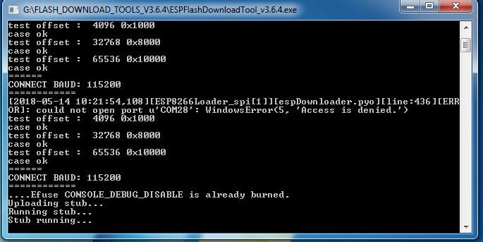

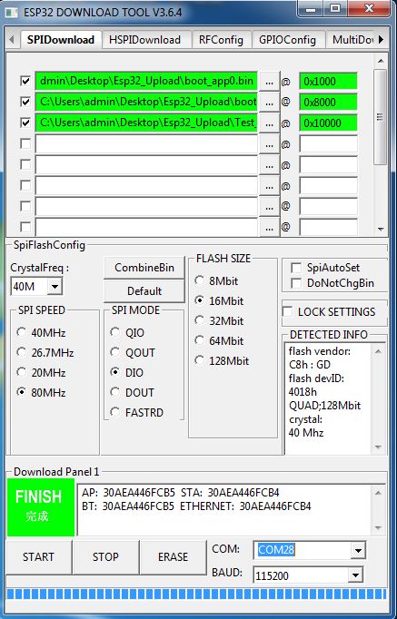

1. Develop the code using Arduino
2.Change output format(.ino) into (.bin).
3.select esp32 flash download tool shown in image below.
4.upload the code,it will loading then finally it shows "FINISH".
5.After then reset the module it shows the error
rst:0x1 (POWERON_RESET),boot:0x16 (SPI_FAST_FLASH_BOOT)
flash read err, 1000
Falling back to built-in command interpreter.
OK
6.how to overcome from this.please give suggestion for flash download tool for esp32 using .bin file.
7.whether the tool is also used for production level...

Re: ESP32 Flash Download Tool produces "flash read err, 1000" on boot
Hi senthil,
I've split your post into a new thread because it doesn't relate to the discussion in the previous thread.
The "flash read err, 1000" indicates that the ESP32 didn't find a bootloader binary at offset 0x1000.
If using Arduino binaries, you need to flash:
- Either ./tools/sdk/bin/bootloader_qio.bin or ./tools/sdk/bin/bootloader.bin (for QIO vs DIO mode) at offset 0x1000
- ./tools/partitions/default.bin at offset 0x8000
- Your app's .bin at offset 0x10000

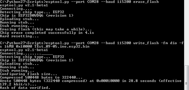

senthil313
- Posts: 8
- Joined: Fri May 11, 2018 5:44 am
Hi Angus,
Thanks for your reply.
I test as per your reference.
Flash -QIO - bootloader_qio.bin for 0x1000
partitions -> default.bin for 0x8000
.bin of source for 0x10000
After programming it show
kindly give any other solution ...
Try changing the "SPI Mode" in the UI from QIO to DIO. The bootloader (bootloader_qio.bin) will be loaded in DIO mode and then it enables QIO mode. This how Arduino ESP32 and ESP-IDF both enable QIO mode.
If this doesn't work, QIO may not be compatible at all. Try flashing bootloader.bin instead (in DIO mode).
Angus
