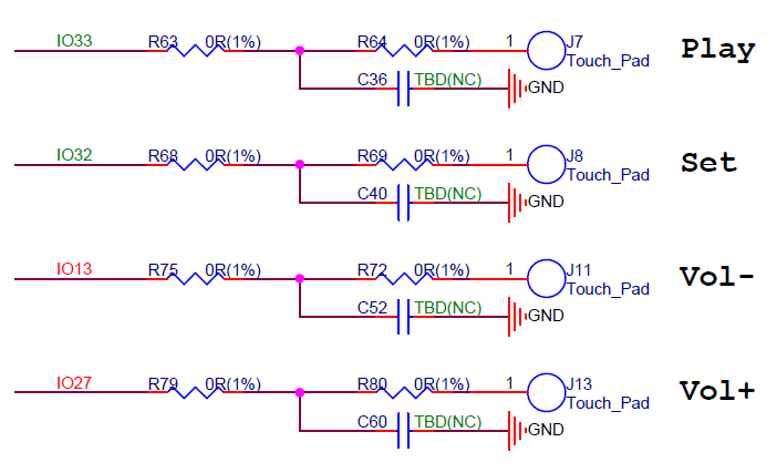

As esp-adf using a new framwork to develop, and Touch Peripheral init is like below :
    periph_touch_cfg_t touch_cfg = {
        .touch_mask = TOUCH_PAD_SEL4 | TOUCH_PAD_SEL7 | TOUCH_PAD_SEL8 | TOUCH_PAD_SEL9,
        .tap_threshold_percent = 70,
    esp_periph_handle_t touch_periph = periph_touch_init(&touch_cfg);
refer to the esp32_lyrat broad HDK,those touch pad are connect to GPIO33,GPIO32,GPIO13,GPIO27
Why does it mapping like below?
TOUCH_PAD_SEL4 ========>GPIO33 ???????
TOUCH_PAD_SEL7 ========>GPIO32 ???????
TOUCH_PAD_SEL8 ========>GPIO13 ???????
TOUCH_PAD_SEL9 ========>GPIO27 ???????
and this make me confused how does TOUCH_PAD_SELX Map into the GPIO_SEL_X ?
if we using different Hardware design, how to config touch pad about TOUCH_PAD_SELX mapping?
BR!!
