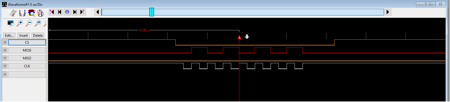

- When writing data on SPI, the slave does not read it correctly. See attached
. Based on the CPHA = 1, latching the data by the slave should happen on the 2nd clk edge (rising edge). Instead of the correct 0x55, the slave reads random data. Shouldn't the MOSI data be shifted to the right by 1 cycle, so that the 01010101b pattern is more stable on the rising clk edge? In the picture I see the 1b on the MOSI rising at the same time as the CLK, on the same edge the slave reads data, so it will not be read correctly.

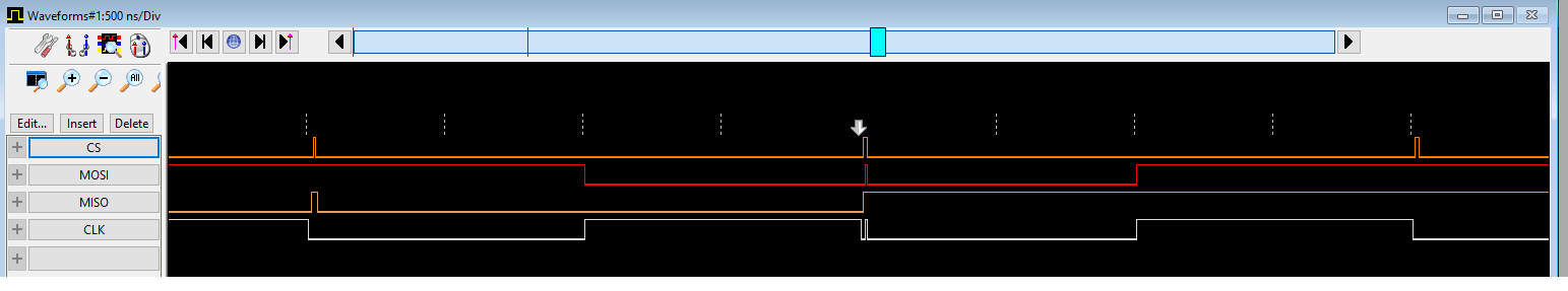

- When reading data on SPI, the master does not read it correctly. See attached
. First of all I always see short pulses on CS line, which causes pulses on all the other lines, even CLK. See attached
. Why are these pulses appearing and why does it influences the CLK, and therefore the transfer? I tried managing the CS from software, and the same pulses occur, so it may not be related to CS, but something else?
- During read, why do I see data on MOSI, as I set the "tx_buffer" to NULL in the read phase, MOSI should be unchanged...

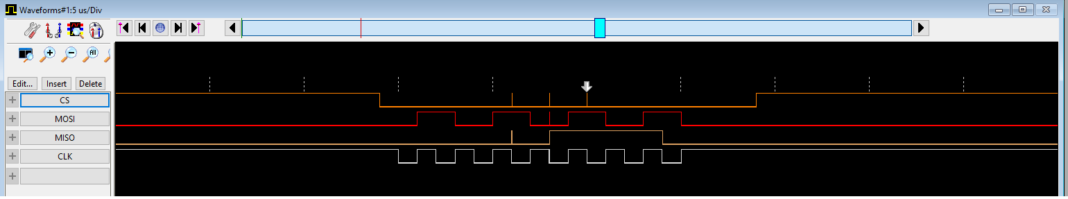

- when exchanging only 1 byte (0x55), I get a much better hit rate, but still sometimes the byte is not received properly at the slave side. the pulses on CS are gone, but I still have short pulses on MISO line, and since the I use the SPI with only 1 phase (read or write, as the other buffer is NULL), I would expect that a master read would have nothing on MOSI line, and a master write would have nothing on MISO line, but this is not the case
- when exchanging more than 1 byte (I test with 4 bytes), I usually get the first frame correctly exchanged, then a lot of frames with 0, some frames just with the first byte received by the slave (and the rest 0), and from time to time I get an additional correct frame

For the speed (500kHz) you used to test, there's no timing issue at all if all the configurations are right. So please don't care about ``no_delay`` and ``dummy`` too much. Set ``no_delay=0`` and ``dummy=0`` it should work.
The maximum frequency is highly related to the slave (MISO delay after the clock). When the slave is ideal, the master can read at 26.6MHz, however, if the slave is slow (like ESP32 slave, which has a MISO delay of 75ns in the worst case), the reading frequency can be no higher than 8.8MHz. Currently the driver is for the ideal case, however the programming guide (till 92c469b5) is a conservative value. We plan to release a patch to allow users to configure the MISO delay by themselves and the driver will calculate the frequency limitation and apply dummy bits and miso delay automatically. I hope this will be merged soon.
The general definition of mode 2 is: CPOL=1 and CPHA=0, see https://en.wikipedia.org/wiki/Serial_Pe ... erface_Bus. The data on the bus meets the timing of mode 2 well. You can configure your slave to mode 2 and try again confidently (Don't for get to revert other timing configurations in the driver).
BTW, the miso/mosi delay mode/num, together with ``ck_idle_edge`` and ``ck_in_edge``/``ck_out_edge`` are for mode timing compensation, and do not 100% correspond with CPOL and CPHA. They should be configured according to the TRM https://www.espressif.com/sites/default ... ual_en.pdf. Touching them may cause unexpected timing issues on the bus. If you have issues use the driver and probably related to the timing, we are glad to help you.
For the random data on the MOSI when read:
In full-duplex mode, the MOSI should always be enabled. If no data is configured, it tries to fetch something from the internal FIFO. Usually we don't care about what's on the MOSI in a time only MISO is meaningful. If you do care about this, prepare a buffer full of 0 for it.
For the glitches on the bus, I guess is about your wiring and ground: Use shorter lines to connect two boards, and connect grounds between them AS MUCH AS POSSIBLE. If this doesn't fix your issue, please come back and let's try to find out what's wrong with the GPIO.
