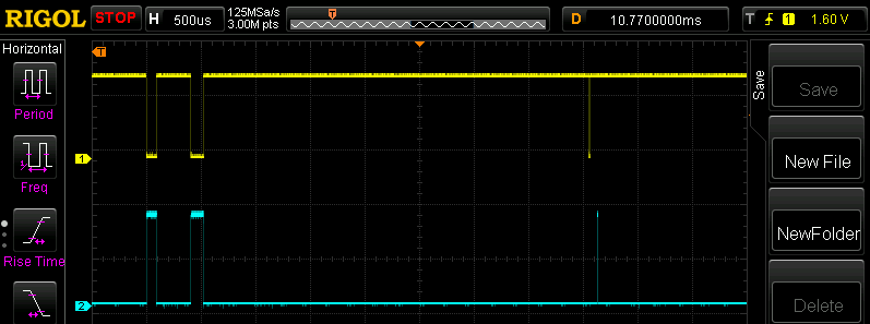

I'm trying to detect some fast events.
I have two signals from two sensors. The signal looks like this :HIGH 60-130 microseconds (us), LOW 0-2700 microseconds (us), HIGH 0-20 microseconds (us). I need to measure the length of each event as accurate as possible.
What is the best approach?

My gut is saying I would look at the RMT peripheral functions. This appears to be able to record pulse transitions down to 12.5 nanoseconds (1/80Mhz). See:

You could probably hack something up by injecting a dummy reference clock for I2S to sample against.Do you think using the I2s infrastructure DMA capable to read this signal would be another viable alternative?
The RMT peripheral is significantly better suited to this, though - I can't think of any way that I2S could be made to outperform it.
RMT is designed to solve almost the exact problem you have, and it's also based on DMA-like functionality so measurement accuracy is not limited by interrupt latency - the pulse timings are written to a memory block, and then an interrupt fires so you can retrieve them.

I did some reading about RMT and it looked too good to be true. And if i'm not mistaking, it is exactly that way.
The main problem is the 16 (or 15) bit resolution. My signal train is exactly 8.3 ms(120 Hz) long. I really need the 12.5 ns (80MHz) granularity because the timebase of my signal is 20.9 ns / tick (48MHz). But at this speed i can't measure the whole train. I need to measure as accurate as possible only t0 and t1. Is there another option to measure this? Thank you

If you have 12.5ns and 32767 samples per entry so max 409us per entry so your total signal should use max 20 entries

Oh I see you are saying the idle threshold can't be more than 819us.
What about mcpwm capture?

Okay, i didn't know about this one, thanks. I'll give it a try. But isn't this based on regular intrerupts? The good thing is that the timer is 80Mhz. Have you tried it for capturing signals?
