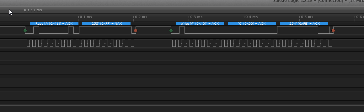

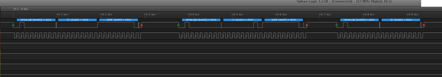

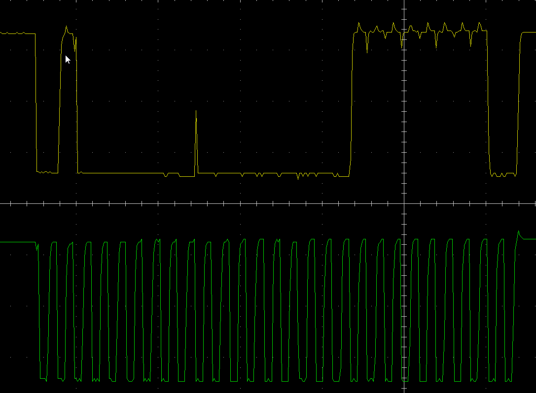

I am playing around with a project and i2c is just driving me nuts. I get occasional freezes of the whole ESP32 what is a show stopper.
As a rookie I want to learn and try to understand what is going wrong - so I bought a cheap scope and logic analyzer.
For pinning down the problems I started by setting up a simple test circuit with just ONE i2c device: a MCP23017 port expander.
Using the standard Adafruit library with the most simple code possible (see code at the end of the post). The code IS WORKING and the pin is turned on as expected. Now I had a look what is going on under the hood.
What I expected:
The slaves adress is 0x20 (as in the documentation as well as in the library as a constant #define MCP23017_ADDRESS 0x20).
Without going too far and pretend to understand what the library is doing exactly, I expected at least some traffic adressing 0x20 after the start condition. Lets say: "Start" -> "Address" (0100 0000) -> Read/Write -> Ack. Then whatever the library is reading/writing to that slave.
What I got instead:
Thats whats on the bus actually - no 0x20 but adressing to 0x40??
0.000007666666667,I2C,Setup Write to [@ (0x40)] + ACK
0.000100166666667,I2C,'0' (0x00) + ACK
0.000192666666667,I2C,'255' (0xFF) + ACK
0.000377083333333,I2C,Setup Write to [@ (0x40)] + ACK
0.000469583333333,I2C,'1' (0x01) + ACK
0.000562000000000,I2C,'255' (0xFF) + ACK
0.000733166666667,I2C,Setup Write to [@ (0x40)] + ACK
0.000825583333333,I2C,'0' (0x00) + ACK
0.000994500000000,I2C,Setup Read to [A (0x41)] + ACK
0.001086916666667,I2C,'255' (0xFF) + NAK
0.001254083333333,I2C,Setup Write to [@ (0x40)] + ACK
0.001346583333333,I2C,'0' (0x00) + ACK
0.001439000000000,I2C,'254' (0xFE) + ACK
5.001864583333333,I2C,Setup Write to [@ (0x40)] + ACK
5.001957083333333,I2C,'20' (0x14) + ACK
5.002120500000000,I2C,Setup Read to [A (0x41)] + ACK
5.002213000000000,I2C,'1' (0x01) + NAK
5.002378166666666,I2C,Setup Write to [@ (0x40)] + ACK
5.002470666666667,I2C,'18' (0x12) + ACK
5.002563083333333,I2C,'1' (0x01) + ACK
See the same communication split up into 2 screenshots as well as the scope log with the first transmission.
Does this makes any sense? Any hint is highly apprectiated!

Have a look at this article:
https://en.wikipedia.org/wiki/I%C2%B2C
Specifically, search within the page for a heading called "Addressing structure" immediately followed by "7-bit addressing". What you will find there is the bit format of an I2C address. Try not to think of I2C as working with a stream of bytes but instead a stream of bits. What you will find is that an address is defined by 8 bits.
The first 7 bits are the address followed by a single bit which defines whether the request (to that address) is a read (1) or a write (0).
What this means is that if you are writing to a device at address 0x20 (remember addresses are SEVEN bits) ... this will be:
0b0100000 - address
0b0 - Write
Which is you were to interpret as 8 bits would be:
0b01000000 -> 0x40
If what you were doing was a read, you would see:
0b01000001 -> 0x41

Postby licht77 » Sun Jul 15, 2018 7:39 am
Aaargh cant believe how obviosly :)
Thanks Kolban - that makes it clear to me of course! Now I can go on and have a look why i2c seems to freeze the whole esp32 chip every now and then...
