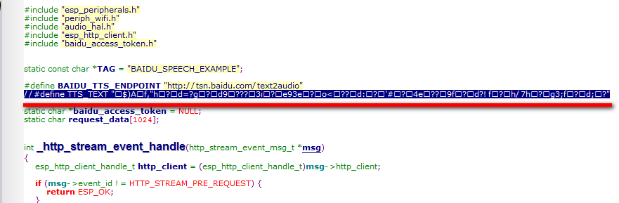

oops, maybe i have not make it clearly!
what i have mean is the file default encoding !
the chinese txt in the c file is showing messy ~~~~like the below picture
so what the default encode should i chose for showing the chinese ?

https://github.com/espressif/esp-adf/bl ... _example.c and other source files are in UTF-8 (without BOM) encoding.

maybe source insight 4.0 do not support UTF8 without BOM!
I always set file encode as UTF8 without BOM, but it always shows as messy code !

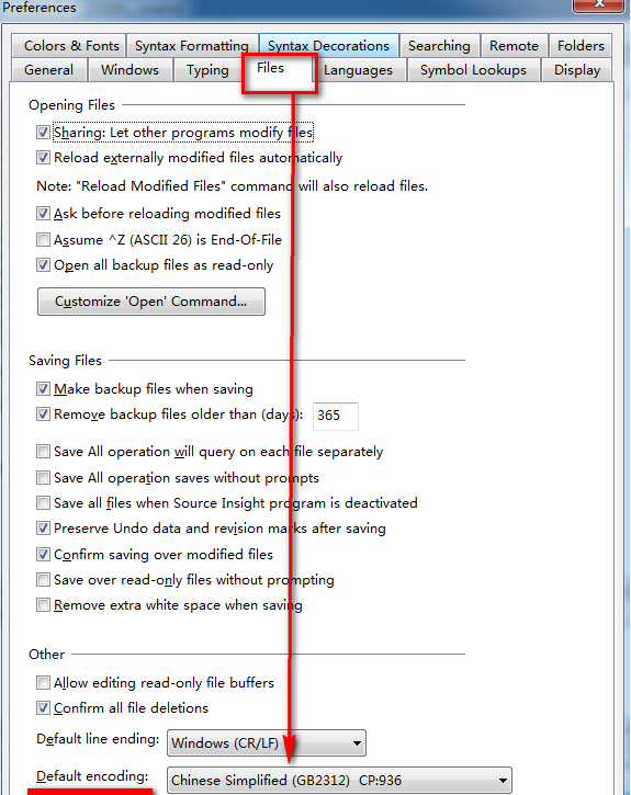

it seems that it is the problem of the software!
