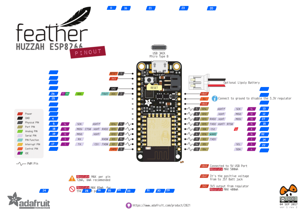

hallo, I have just spent too much time trying to map out my new Adfruit feather ESP-32 and this is what i have found....
Pls ignore the base image as it is for a 8266, the blue tags are labled with the pin number that worked as an output pin for me..
Use at your own risk.. Hope this helps someone :mrgreen:
