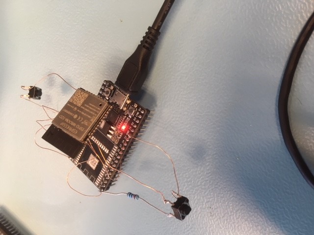

Actually I disoldered the module WROOM from the devkitc and I only connected the UART pins, VCC, ground and EN and GPIO0 to gnd with buttons the last two of them. So if I don't press the button ENABLE and GPIO0 are floating if I press the button the go low.
I wanted to verify that I can program the chip through UART without using the dev board.
No I try to talk to the ROM bootloader through esptool.py through UART but it is trying by default to use SPI.
Is it possible to use UART instead somehow?
Thank you in advance.

Hi anakyr,
The error message "ESP32 ROM does not support command erase_flash" suggests that esptool.py is talking to the ESP32 ROM bootloader.
The error message is because some commands are not supported in "--no-stub" mode, because they rely on uploading a software "stub bootloader" to IRAM and then running this loader program. You can either remove the "--no-stub" argument, or try a different command.
