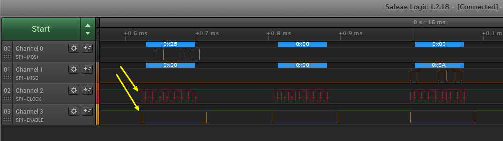

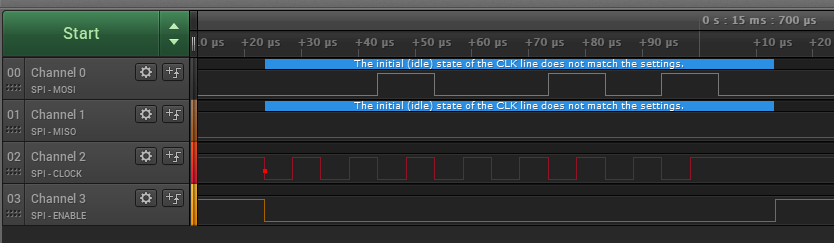

When capture signal on my digital analyzer in mode 3, the digital analyzer always complains "CLK idle error". If I set my digital analyzer to mode 0, it can decode the signal. I found the CS pulls down at same time of CLK. Should the CS pull down before CLK?

Generally CS should be always toggled before CLK signal. There is a hardware bug where setting cs_ena_pretrans does not have any effect in full duplex.
You can control CS line as GPIO (set it low before SPI transmission, set it high after transmission).
