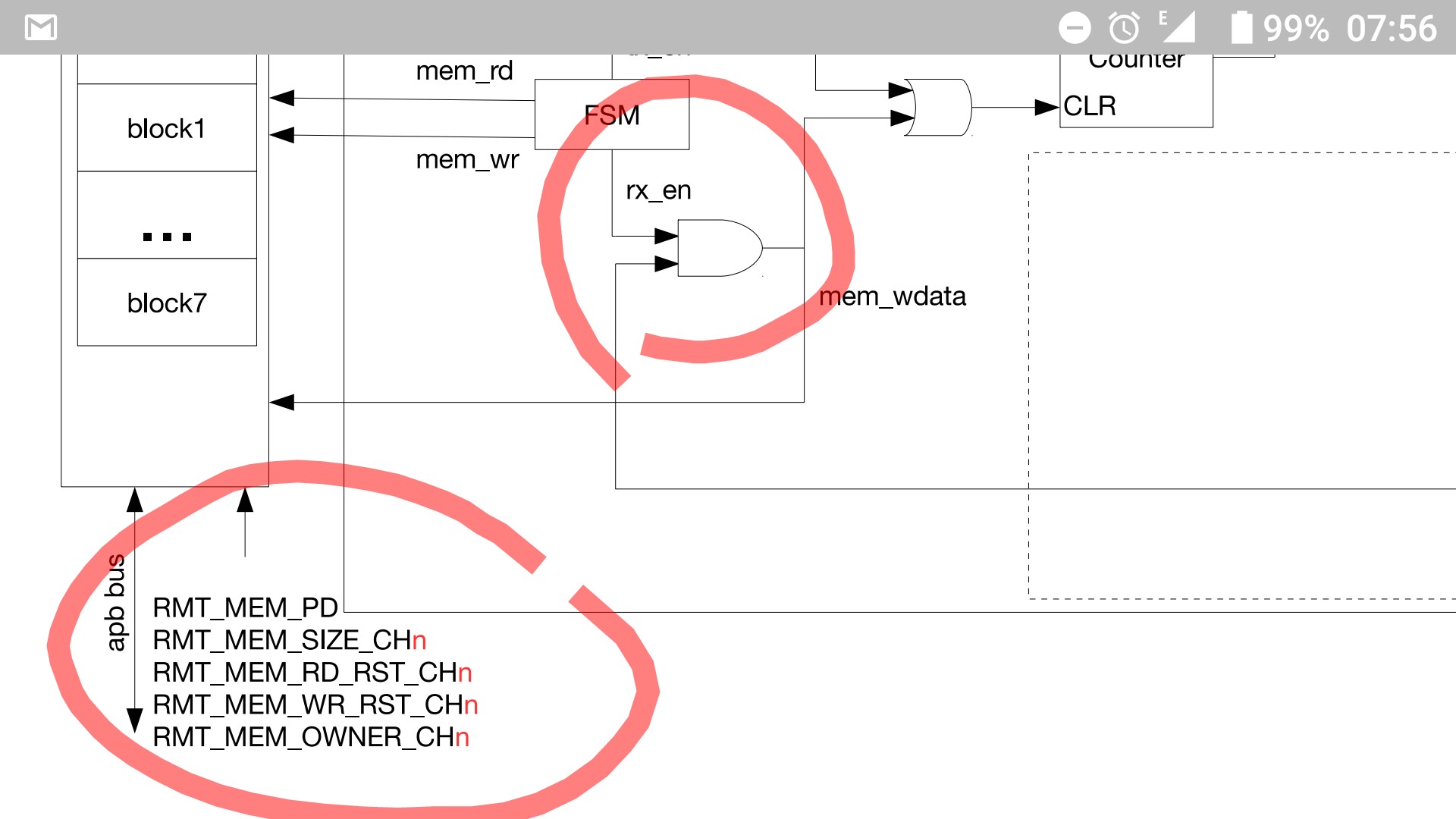

I'm still investigating to get my own RMT interrupt running. At the moment I'm worrying, if rx_en is really enabled with my code above and if I'm really accessing to the correct memory address (RMT_MEM_PD)?? Would be happy to find someone who has some experience with it... Thx

Postby WiFive » Wed Oct 17, 2018 9:58 am
Markus391
Posts: 6
Joined: Sat Oct 13, 2018 11:56 am
Re: RMT interrupts
Postby Markus391 » Wed Oct 17, 2018 10:19 am
Thanks for letting me know....Seems like I'm on the correct way. But why no data? I will next try to unset the enable bit and ownership. Looking forward what happens.....Thx again

Postby Markus391 » Wed Oct 17, 2018 6:13 pm
Wow, actually it succeeded as follow..With the following interrupt routine I was able to get data for channel 0:
void IRAM_ATTR rmt_isr_handler(void* arg){
  //read RMT interrupt status.
  uint32_t intr_st = RMT.int_st.val;
  RMT.conf_ch[0].conf1.rx_en = 0;
  RMT.conf_ch[0].conf1.mem_owner = RMT_MEM_OWNER_TX;
  volatile rmt_item32_t* item = RMTMEM.chan[0].data32;
  if (item) Serial.print ((item)->duration0);
  RMT.conf_ch[0].conf1.mem_wr_rst = 1;
  RMT.conf_ch[0].conf1.mem_owner = RMT_MEM_OWNER_RX;
  RMT.conf_ch[0].conf1.rx_en = 1;
  //clear RMT interrupt status.
  RMT.int_clr.val = intr_st;
Thank you so much again.....
