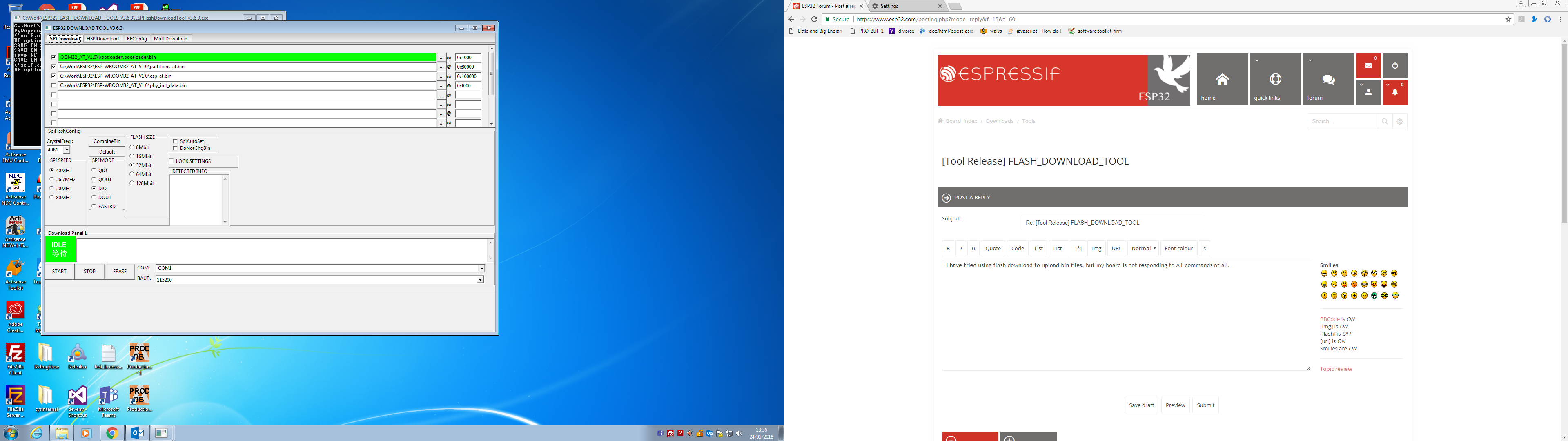

I have tried using flash download to upload bin files. but my board is not responding to AT commands at all.
I have attached my screen shot to show selected files uploaded.
Angus
Posts: 2344
Re: [Tool Release] FLASH_DOWNLOAD_TOOL
Postby Angus » Thu Jan 25, 2018 4:02 am
Hi snahmad75,
Looks like there are one too many 0s in the addresses for partition.bin and esp-at.bin.
Angus

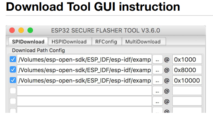

Posts: 1756
Postby rudi ;-) » Thu Jan 25, 2018 10:07 am
ok, tell me correct addresses.
1000 8000 10000
RTFM that comes with this tool
it is named "README" why you think it is named so :mrgreen:
:D
edit: there are many good "Getting Started" RTFM's
and i think you will need to read AT instruction too.
Further RTM's
and here customs RTFM'S
:D
have phun!
