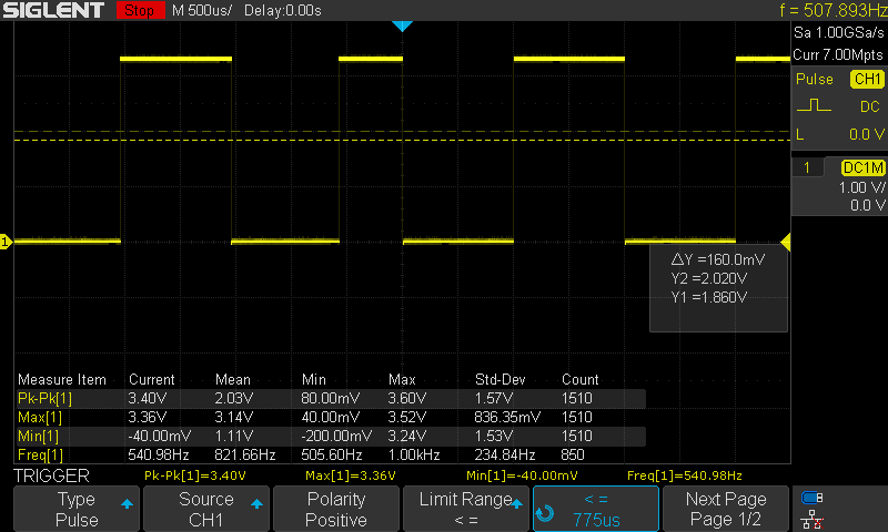

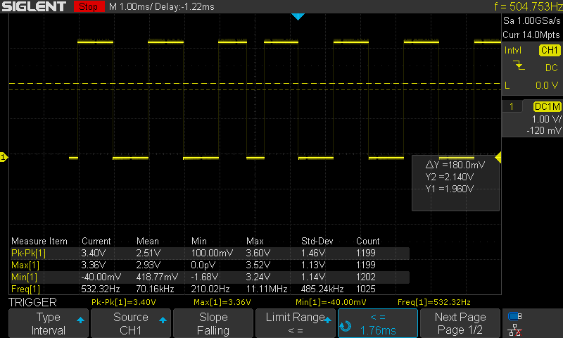

ardiehl
Posts: 7
Joined: Fri Oct 27, 2017 10:44 pm
Re: LEDC unstable frequency
Postby ardiehl » Tue Dec 04, 2018 10:33 am
the problem is still present. It works when i do not enable "Enable dynamic frequency scaling (DFS) at startup"
If this option is enabled, the ledc frequency is >99% wrong, it looks like this (half the requested frequency and unstable)

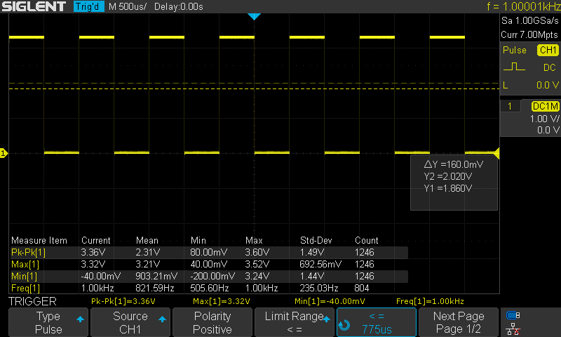

with disabled "enable "Enable dynamic frequency scaling (DFS) at startup" it looks like this:
This is 1KHz and it is rock solid stable.
