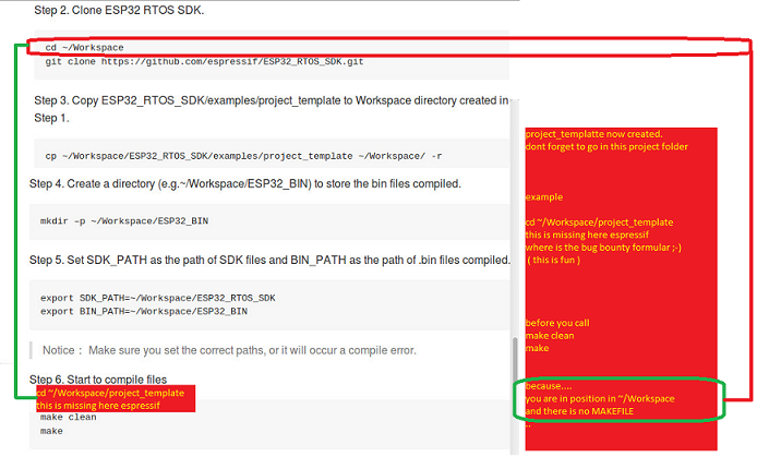

my second workaround:
think there is a little mistake in "Project Template Compile" Part,
must add
cd ~/Workspace/project_template
before Step 6
make clean
make
because we are in ~/Workspace
( See Step 2 in this Part )
and there is no MAKEFILE

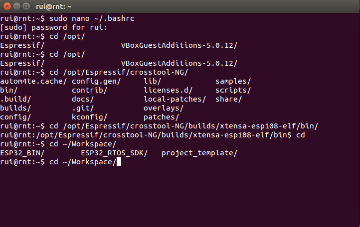

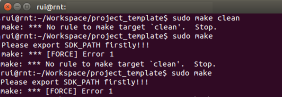

RuiSantos
Joined: Sat Dec 19, 2015 9:27 pm
Re: workaround install toolchain
Postby RuiSantos » Sun Dec 27, 2015 12:16 pm
Hi Rudi,
Thank you for sharing your experience on preparing the work environment.

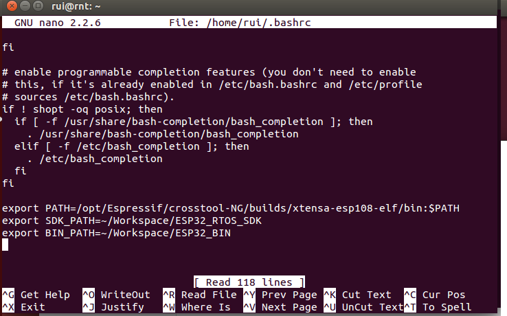

I'm having a problem and I don't know how to fix... I've followed these instructions to install everything: https://github.com/espressif/ESP32_RTOS_SDK
I've installed the toolchain successfully in the recommended directory.
I've also downloaded the sdk to the ~/Workspace folder and I've followed all the instructions.
I've also added the exports to the ~/.bashrc
When I go to the ~/Workspace/project_template
And I run the command make clean && make I get this:
make clean and make.png (37.16 KiB) Viewed 15623 times
Do you know how to fix it? I think I've defined all the paths properly and I checked everything multiple times...
I'm using Ubuntu 14 with VirtualBox.

Postby Baoshi » Sun Dec 27, 2015 3:02 pm
Rui,
Do not put sudo before make, that should work.
Baoshi

Postby RuiSantos » Mon Dec 28, 2015 11:31 am
Rui,
Baoshi
Thanks for the suggestion. I've tried and it actually solved my problem Baoshi. It was a permissions issue, if I did:
make clean && make
It was saying permission denied, so I've tried with the
sudo make clean && sudo make
Unfortunately that doesn't work, because it needs to be the $USER running that command. To solve this issue I simply ran:
sudo chown -R $USER ~/Workspace
make clean
make
And finally compiled.
