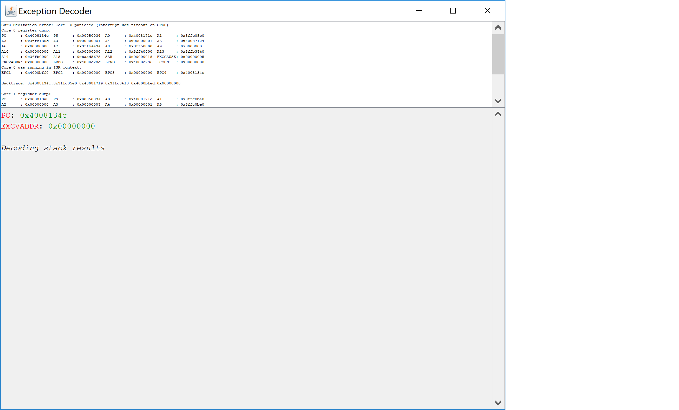

I'm facing this problem that happens sometimes in a no repeatable way :? .
I use platformIO with arduino framework to write code for the esp32 and I am using the 2 cores. This problem occurs on CPU0 only, here is the backtrace:
Guru Meditation Error: Core  0 panic'ed (Interrupt wdt timeout on CPU0)

I tried to use exception decoder inside arduino IDE with selecting the firmware.elf generated by platformIO but it returns nothing I can use to debug:
I also read lots of posts dealing with these kind of problems and it was question of gdb and addr2line but I do not know how to use this kind of tools :shock:
Do you have any idea of the way to solve this pb?

I ran addr2line with the firmware.elf file:
xtensa-esp32-elf-addr2line -pfiaC -e firmware.elf 0x4008134c
It returned:
0x4008134c: _uart_isr at esp32-hal-uart.c:?
I think the problem is coming from this portion of code (because of "out of sync" uart buffer phenomenon that appears in some situations , I need to restart 1 uart peripheral and it seems to cause this error some times):
SerialSBUS.end();
delay(10);
SerialSBUS.begin(BaudRate, SERIAL_8E1, RX_Pin, TX_Pin);
delay(10);
Does anybody have an explanation of this error or a test I could do to find a solution? :)

Weskrauser
Posts: 10
Joined: Thu Sep 07, 2017 8:39 pm
Re: Guru Meditation Error: Core 0 panic'ed (Interrupt wdt timeout on CPU0)
Postby Weskrauser » Thu Jan 03, 2019 10:10 pm
@idahowalker : thanks for your answer!
I did that and confirm that these two lines are the cause of my pb ^^:
SerialSBUS.end();
delay(10);
delay(10);
I can not explain why but this is causing the wdt error if repeated, even with the delays. I now use SerialSBUS.flush() instead to reset the buffer and no more guru meditation :roll:
