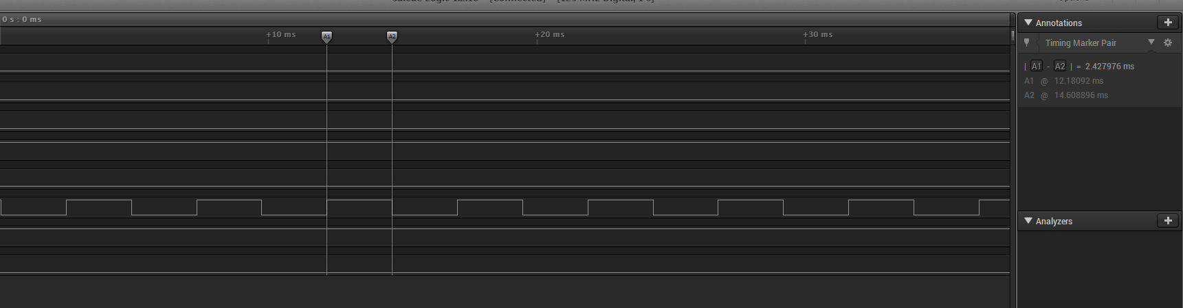

If I uncomment one of the Timer_Init functions, then the timer works fine. (picture shows timer0)

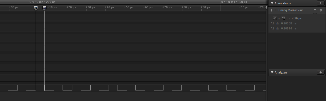

As soon as I try to init both timers this happens:
It seems, that the Handler2 function always gets its task notification.
But why? Does the interrupt get constantly triggered?

I see a few issues with your code:
- You declare Timer_Specs as static. This means there's only one of them through your entire code. This means that as soon as you initialize the 2nd timer, you overwrite the Timer_Specs data in the 1st timer. In this case, you're better off doing something like 'Timer_Spec_t Timer_Specs_p = calloc(sizeof(Timer_Specs_t), 1)' to allocate a new instance every time the init function is called.
- With your line 'Timer_Spec_t Settings = *((Timer_Spec_t *) para);', I think the compiler copies all the settings from your original object to a local Settings variable, which you then proceed to use. There's no real harm in that at this point, but do note that changes to Settings won't propagate back to the original Timer_Spec_T object that gets fed into the ISR. Better use a pointer: 'Timer_Spec_t *Settings_p = ((Timer_Spec_t *) para);'
Note that both changes result in a Timer_Spec_t pointer rather than an object being used, so you'll need to reference to members with `Timer_Specs_p->Taskptr=bla` instead of `Timer_Specs.Taskptr=bla`.

thanks for your help and your really good explanations. I didn't pay attention to the static variable being used multiple times, as soon as using multiple timers. Now it's totally clear for me :oops: .
So I corrected my code and everything works fine :)
