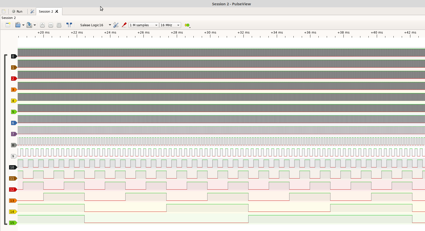

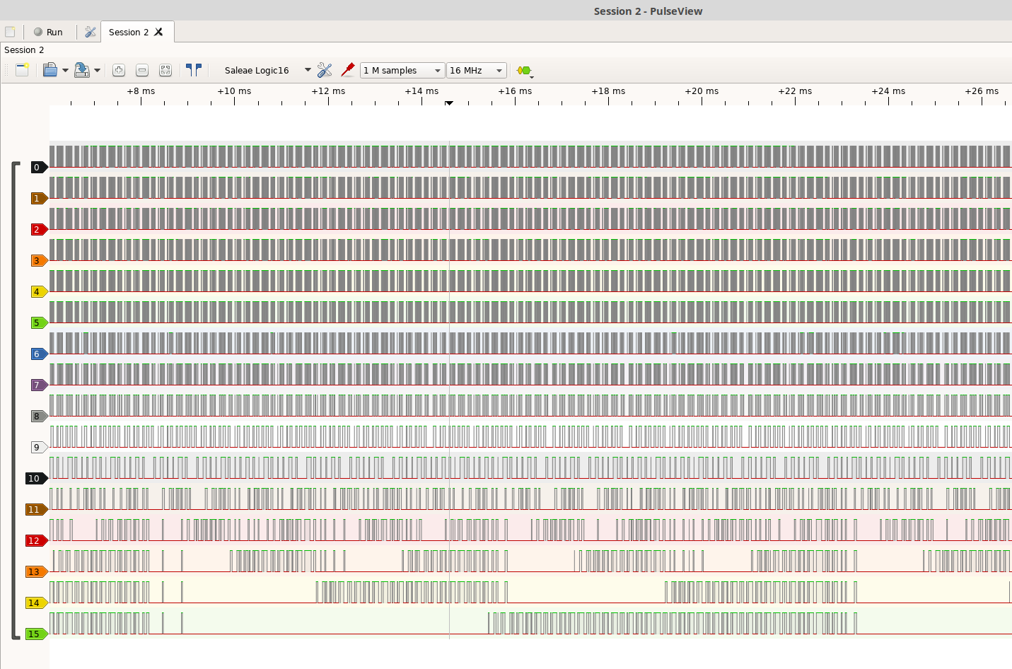

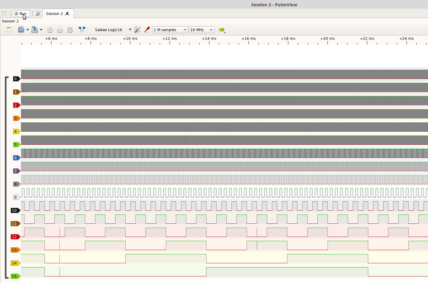

I've used your printercart_simple example as a starting point for the i2s parallel driver. For my case I need to output at 10 MHz I've managed to reach this speed using a single buffer and no EOF interrupts, but I'd like to implement continuous transmission. I now have a circular DMA link with 4 buffers and EOF interrupts working but it outputs garbage when clocked above 3.33 MHz. I'm using dummy data in a queue to block the main loop on core 1 until a buffer is free to fill, when a EOF interrupt occurs on core 0 the dummy data is removed from the queue allowing the main loop to run refilling the buffer. I'm currently just using it to count from 0 - 65535 to check its working correctly.
How can I get this to clock faster without breaking?
Would it be more effective to use many small buffers or a couple of large buffers?
Would it be better for the interrupt to give the main loop a semaphone which then allows the main loop to update the buffer?
The code can be found below or on github...

Running at 3.33 MHz, Looks perfect can clearly see counting from 0 - 65535:
Running at 4 MHz, Starting to break at the start of some buffers but counting is still visible:
Running at 10 MHz, Complete Garbage but some counting patterns can be seen:
