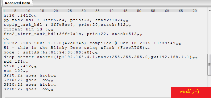

hi
a simply blinky demo with xTask ( FreeRTOS )
we can mask the gpio too.
but this shows the simple things.
have used simple api:
GPIO_OUTPUT_SET( gpio_no, bit_value )
for your free using:
 * user_main.c
 *  Created on: 30.12.2015
 *      Author: rudi ;-)
 *      Free Blinky example by using the xtask in freertos
 *      do not forget to use lib: driver
 *      in makefile for gpio
// change this to your right paths
#include <esp_common.h>
#include <../driver_lib/include/gpio.h>
#include <../freertos/task.h>
#include <../freertos/FreeRTOS.h>
// select your gpio here
// do not use gpio 23
// there is no gpio 23 :) on esp31b alias esp32beta
const int gpio = 22;
/* task to blink an LED.
 * simple used
 * GPIO_OUTPUT_SET( gpio_no, bit_value )
 * 1s (1000ms) high
 * 3s (3000ms) low
 * if you connect led+ to powersupply+ and led- to the gpiopin 22
 * then led is on if pin is low ( 0 ) and will 3s (3000ms) on, and 1s (1000ms) off
void blinkyTask(void *pvParameters)
// ESP32
// GPIO_OUTPUT_SET( gpio_no, bit_value )
	while(1) {
		printf("GPIO:%i goes high\n",gpio);
		GPIO_OUTPUT_SET( gpio, 1 );
		vTaskDelay(1000 / portTICK_RATE_MS);
		printf("GPIO:%i goes low\n", gpio);
		GPIO_OUTPUT_SET( gpio, 0 );
		vTaskDelay(3000 / portTICK_RATE_MS);
void user_init(void)
	printf("Hi - this is the ESP32beta Blinky Demo using xTask (FreeRTOS)\n");
	xTaskCreate(blinkyTask, (signed char *)"blinkyTask", 256, NULL, 2, NULL);

Postby chrisfraser » Sun Jan 03, 2016 9:50 pm
Nice work Rudi. This helped me get off the ground. Please check the above code as I think you will get errors if gpio is const.
I have packaged a similar thing for Eclipse on Ubuntu. Check out: https://github.com/chrisfraser/esp32_blink

..will get errors if gpio is const.
hi chris
you're welcome!
const makes fail ?
have tested just in time with UO ESP32 develop kit eclipse: newbuild, compile and run.
i took const because gpio in this example goes fixed, only value for this then can changed.
normally is ok, but you can comment const and use it without const. perhabs my config is not right.
// gpio do not use gpio 23 there is no gpio 23 :) on esp31b alias esp32beta
// const make errors noted online
// by chrisfraser » Sun Jan 03, 2016 10:50 pm
// rudi to do: check it again whats wrong
// const
int gpio = 22;
but will check again
