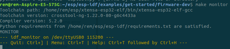

Do you have any ideas how I could see my results and the print messages I used in my code ? When I'm using make monitor I only have the lines in the attach file.

Which development board are you using? Based on lack of monitor output, it seems that /dev/ttyUSB0 is not connected to the UART of ESP32. If you see multiple /dev/ttyUSBx ports in your system, you might try other ports and see if one of them works.

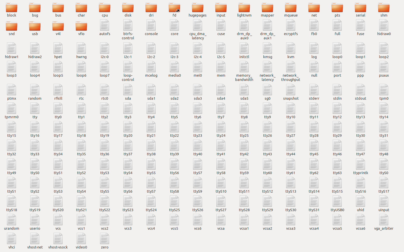

It seems that I only have ttyUSB0 in my dev file. Else it's only ttyXX ot ttySXX

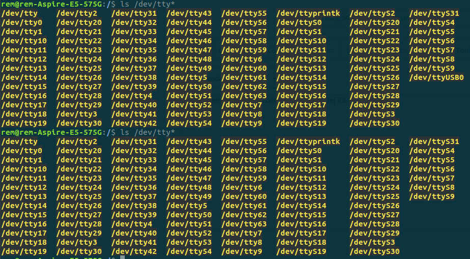

And when I'm running
ls /dev/tty*
it's the ttyUSB0 that appear and disappear when I plugged and unplugged my esp32.

I believe the single ttyUSB0 you see is associated with olimex-arm-usb-ocd-h and works for the JTAG interface only. To flash with "make flash" you need a separate USB-to-serial interface dongle connected to the UART pins I mentioned above.
