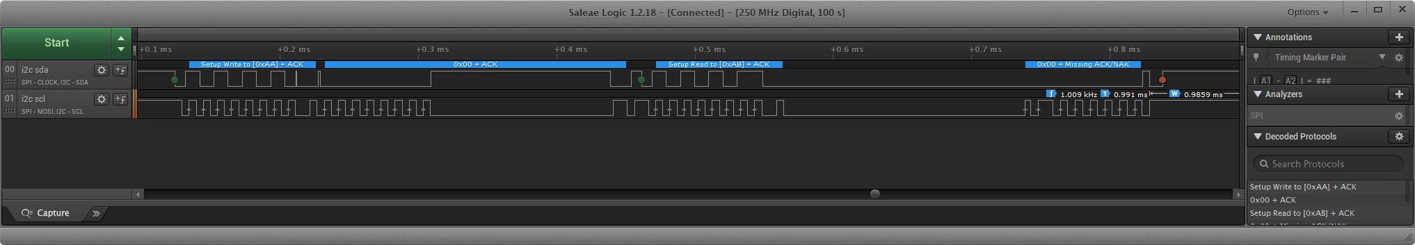

I almost thought this would be the right medicine for the problem but no there are still problems. I have included recordings with different frequencies and one can see where it goes wrong. I have done test using 10, 100, 400 Khz and only 10KHz works both with version 3.2 and master. I feel that I am close to a solution now but there is still something that is not quite rigth.
This is the 100KHz recording where it goes wrong.
3.2 DFS on with power locks 100KHz.png (78.43 KiB) Viewed 10569 times

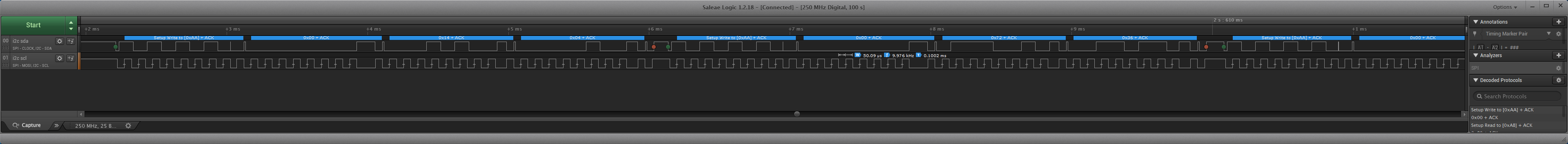

This is a recording with 10KHz that works.
3.2 DFS on with power locks 10KHz.png (92.39 KiB) Viewed 10569 times
