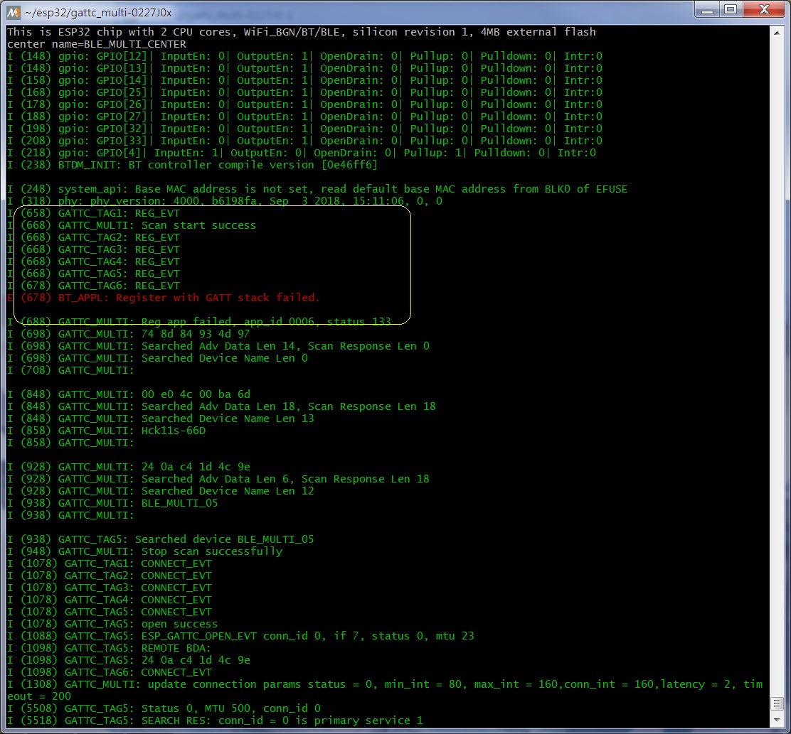

I try to modify the example code of "gattc_multi_connect". I hope that it can be used to connect to seven GATT servers at the same time. But it could only connect to six GATT servers, and appear a error message ---"BT_APPL: Register with GATT stack failed. ".
ps. detail message as attached jpg file
ps. `I have set "BT/BLE MAX ACL CONNECTIONS" to 7

I try to modify the configration parameter. Now it run well.
make menuconfig
Component config --->
Bluetooth --->
Bluedroid enable --->
Include GATT server module(GATTS) = cancel
BT/BLE MAX ACL CONNECTIONS(1~7) = 7
BT/BLE will first malloc the memory from the PSRAM = enable
