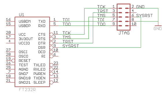

Can you please tell me wiring for FT232 module ?

Anyway, here it is the ft232 jtag connection diagram Please note that you will have to change the debug cfg file to match the adapter you use.
By default, ESP32 is set to work with ft2232 chip (esp-wroom-32.cfg and esp32_devkitj_v1.cfg)

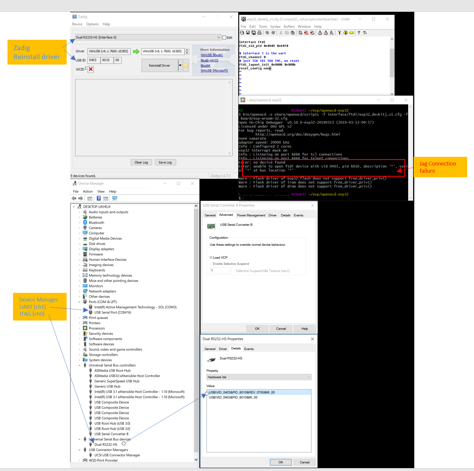

Hi Experts,
I am very new to ESP32 development desperately help on JTag setup. I spend my whole day in futile attempt and running on circles.
I will very much appreciate if someone who has use JTAG in Wrover kit under Windows OS can suggest some pointers

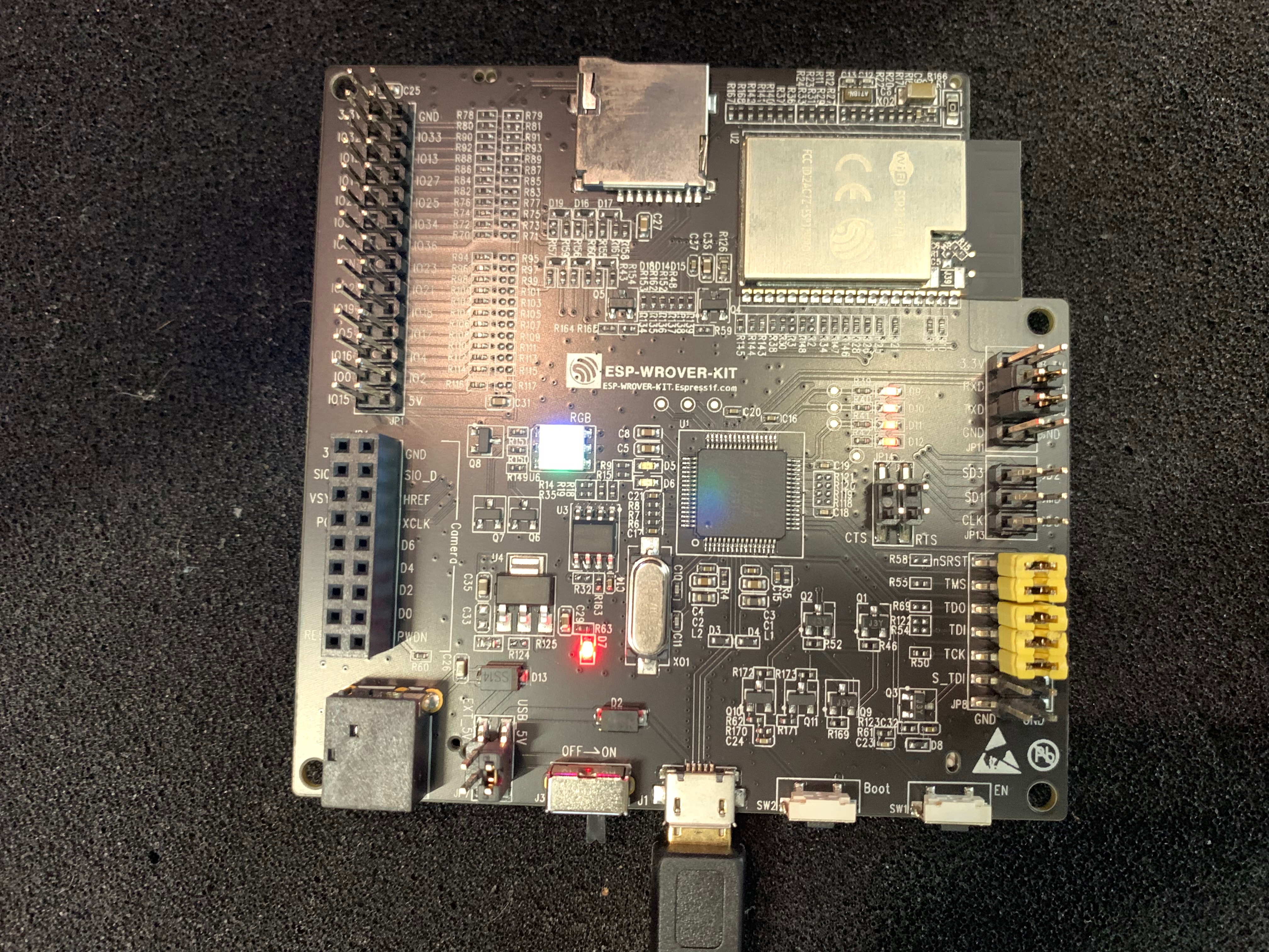

I am able to build various ESP32 samples and mostly use serial out for debug. Now I like to use JTAG and bought Wrover Kit for the sole purpose of ease of setup install so I can focus on code. I am able to load and get serialprint to work via all paths - Arduino IDE, Eclipse as well as Windows (I am using Windows 10) command line using msys32\mingw32 build environment.. if only I can get JTAG to work
I will very much appreciate your suggestions and Thank you very much
Alok

I followed step-by-step setup guide as well as other posts (ex: https://www.ftdichip.com/Support/Docume ... s%2010.pdf) with no luck.
Steps:
1. When I connected the board via USB board both port shows up.
2. I added the 5 jumpers as suggested for JTag (see attached)
3. Run Zadig tool to reinstall the driver for interface 0 (see picture attached).
4. I installed OpenOCD tool
5. Run openccd tool as below but it keeps reporting device not found
There are no device/sensor attached to board and its running fine (I can see the serial print message from interface 1 of UART)
I am obviously missing somethings as this has been widely used with no issue. But I am not sure what is missing. I try to build openocd source under windows but run into many build issues there so stuck
My next attempt may be to switch to Linux and see I can get any better luck. I prefer Windows environment if I can make this work
Error Log:
$ bin/openocd -s share/openocd/scripts -f interface/ftdi/esp32_devkitj_v1.cfg -f board/esp-wroom-32.cfg

Error: no device found
Error: unable to open ftdi device with vid 0403, pid 6010, description '*', serial '*' at bus location '*'
