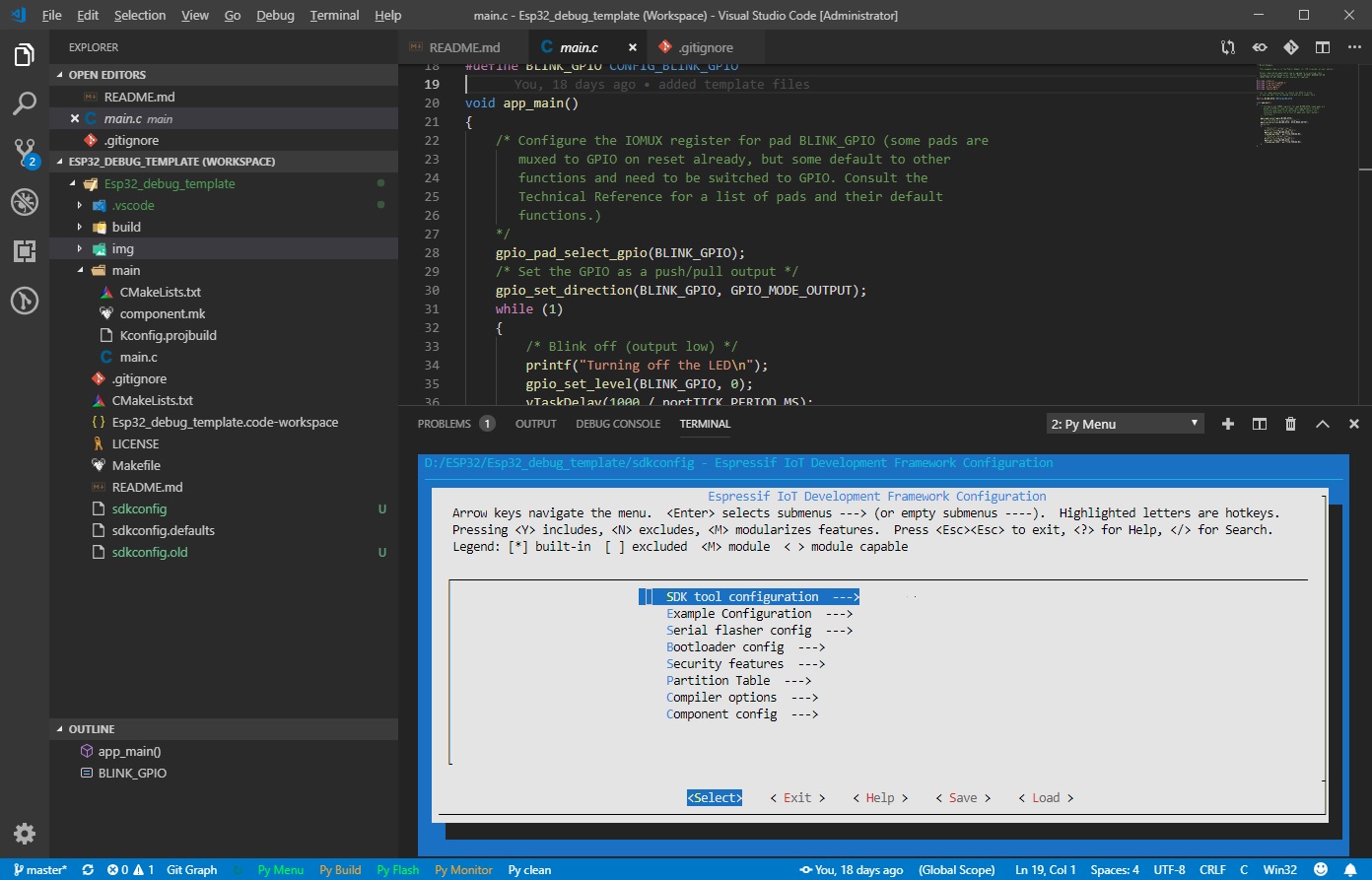

I made a VsCode project template/tutorial that include debug settings and operation buttons:
Menuconfig, Build, Flash, Monitor, Clean.
https://github.com/botofancalin/Esp32_debug_template
The project name is named using project folder name.
So if you need your own project, just rename the folder from "Esp32_debug_template" to your project name
Menuconfig and other operations run on VsCode terminal window.

- menuconfig.jpg (253.23 KiB) Viewed 10208 times

Hey CalinB!
Thanks for your input! I will definitely look at those tools because VSC needs some extension that would make things easier for esp development. Intellisense should be more filtered just to the project objects.
