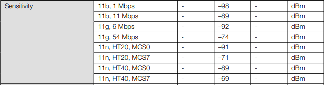

Hi, I have been looking through some of the datasheets of the ESP32 particularly at the WiFi modulation rates and initially I found that most datasheets only claim data rates of 6 and 54 Mbps on 11g like shown below:
esp-wroom-32 data rates.PNG (24.88 KiB) Viewed 4209 times

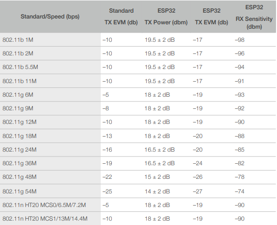

But recently I found the FAQ docs for ESP32 (https://www.espressif.com/sites/default ... Qs__EN.pdf) to advertise all the data rates in between 6 and 54 Mbps.
ESP32 FAQ data rates.PNG (54.67 KiB) Viewed 4209 times
Is the ESP32 capable of using the intermediate datarates like the FAQ states? If so is it enabled by default?

Yes, the first table just lists the lowest and highest
https://github.com/espressif/esp-idf/bl ... pes.h#L456
