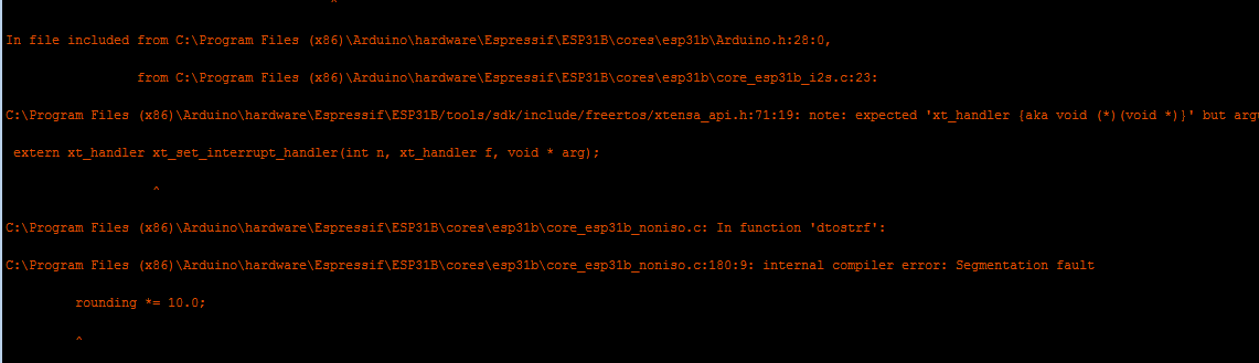

Re: Unofficial Development Kit for Espressif ESP32 (Windows)
hi
because:
"Segmentation fault
rounding *= 10.0;
not sure, perhabs this use in gcc configure
rudi
because:
"Segmentation fault
rounding *= 10.0;
--enable-decimal-float=yes
rudi

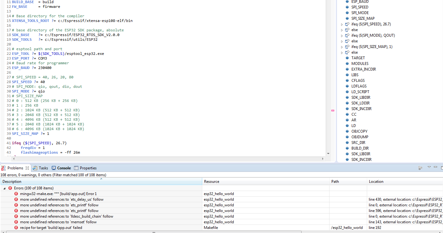

Somebody tried to migrate to SDK V2.0 ?
Me, I got 108 errors during build.
I'm trying to find the route cause and fix it...
Br, Xatax
Br, Xatax
- Capture.PNG (78.84 KiB) Viewed 50426 times
