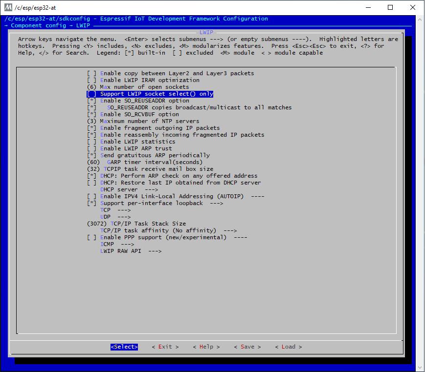

Hi.
When I turn on WiFi
Code: Untitled.cpp Select all
esp_err_t wifi_setup() {
esp_err_t ret;
WiFi.mode(WIFI_STA);
WiFi.disconnect(true);
WiFi.onEvent(WiFiEvent); //not depend
delay(100);
return ESP_OK;
sdio_slave is hangs.
I also try init with low level:
esp_err_t wifi_setup(void)
//s_wifi_event_group = xEventGroupCreate();
esp_err_t ret;
tcpip_adapter_init();
ret = esp_event_loop_create_default();
if (ret != ESP_OK) return ret;
//cfg.event_handler = NULL;
ret = esp_wifi_init(&cfg); //OK BUT SDIO HALTED AFTER
if (wf_debug)
if (ret==ESP_OK) Serial.println("WiFi= Init OK ");
else Serial.println("WiFi= Init ERR ");
ret = esp_event_handler_register(WIFI_EVENT, ESP_EVENT_ANY_ID, &event_handler, NULL);
ret = esp_event_handler_register(IP_EVENT, IP_EVENT_STA_GOT_IP, &event_handler, NULL);
// wifi_config = {
// .sta = {
// .ssid = DEFAULT_SSID,
// .password = DEFAULT_PWD,
//// scan_method : DEFAULT_SCAN_METHOD,
//// sort_method : DEFAULT_SORT_METHOD,
//// .threshold.rssi = DEFAULT_RSSI,
//// .threshold.authmode = DEFAULT_AUTHMODE,
return ret;
sdio hangs after esp_wifi_init() :twisted:
Please help, what happened?

Try selecting the following option in "make menuconfig"
Component config / LWIP /USE_ONLY_LWIP_SELECT [=y].

Hi felixcollins.
Thank for reply.
I had no find this option in LWIP section.
With the best regards.

I check "Support LWIP socket select() only" because
https://github.com/espressif/esp-idf/bl ... ip/Kconfig.

Hi.
I tried to change, but nothing has changed. Can there be something else?
Also I tried to change directly in sdkconfig.
Who can tell, after changing sdkconfig, I need to do something else if I work in the Arduino IDE?
