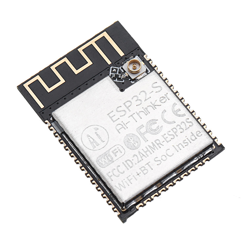

I decided to use the ESP32-S, since it provides a PCB-antenna and an IPEX-antenna. I am wondering what I need from a hardware perspective to be able to switch between the PCB antenna and the IPEX antenna?

There is a jumper (tiny 0 ohm resistor) which has to be connected to either the PCB antenna or the ipex connector. You can see in this photo it is connected to the ipex, which means the pcb antenna is not connected. So you need either soldering tweezers or a hot air gun and steady hands.
