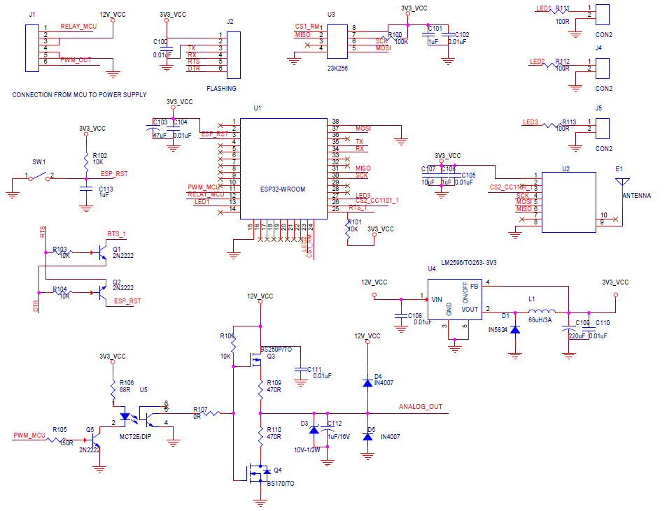

I am using ESP32 Wroom in a product. After a month of operation the devices stops working. We find that the device does not boot. If I try to flash ESP32, I am getting the error following. The devices were purchased from a reputed online vendor.

Replacing ESP32 fixes the problem. I believe its a reliability issue with ESP32, has anybody faced such reliability issues with ESP32 Wroom?

This seems very unusual. Has it happened to more than one device?
As nevercast suggests, this may be possible if physical conditions have damaged the WROOM module in some way.
How are you resetting the WROOM into bootloader mode? If you connect a serial program at 115200bps and look at the serial output from the device while resetting it manually, do you see any output?

This has happened to six to nine devices out of 148. At 115200bps I got 3 different results in nine devices.
  • In one device it is printing following message continuously.
    configsip: 0, SPIWP:0xee
    mode:DIO, clock div:1
    load:0x3fff0018,len:4
    load:0x3fff001c,len:952
    load:0x40078000,len:6084
    load:0x40080000,len:7936
    csum err:0x37!=0xd7
    ets_main.c 371
    ets Jun 8 2016 00:22:57
  • In two devices it is printing following message continuously.
    flash read err, 1000
    ets_main.c 371
  • In 6 devices it is not print anything.
Please check below schematic.

Looks like a continuous reset. Perhaps a pull up resistor on the Reset line.

Postby WiFive » Wed Jul 03, 2019 5:09 am
No protection on 12v input?
Hai,
12v input is from SMPS. Which protection is needed?

I would suspect a power supply issue with an unstable 3v3 seeing much higher spikes.
There is no series diode on the input to the regulator. Use a schottky or fast recovery diode.
There is no protection on the 12v. I would use a transzorb or TVS diode across the 12v supply, and include a fuse too.
The 0.01uF input capacitor on its own is useless, use 470uF-680uF as well.
