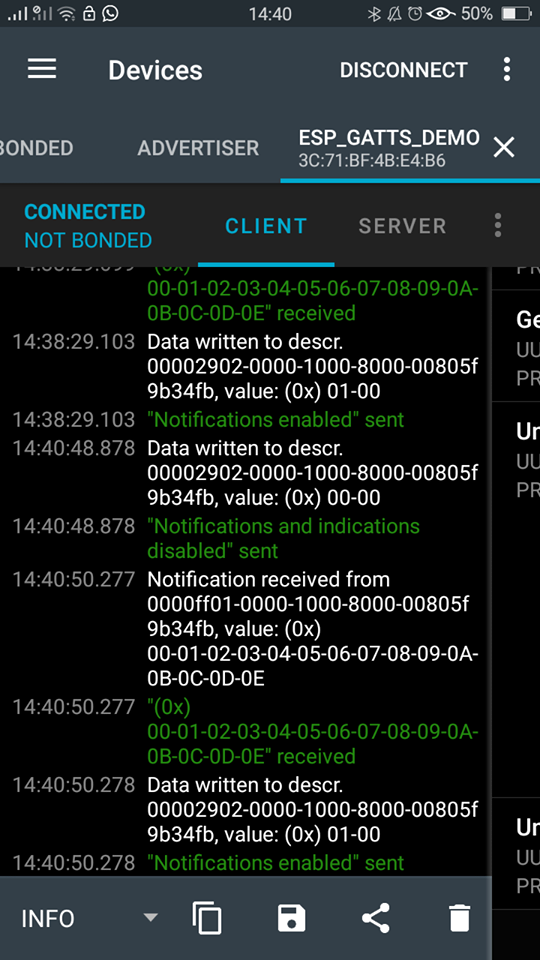

Dear All,
I am working with example gatt_security_server in esp-idf and when I tested it with nordic mobile application, it just did not return any value to the nordic.
So I check the example code and found out that they just leave it blank like this :
case ESP_GATTS_WRITE_EVT:
            ESP_LOGI(GATTS_TABLE_TAG, "ESP_GATTS_WRITE_EVT, write value:");
            esp_log_buffer_hex(GATTS_TABLE_TAG, param->write.value, param->write.len);
So, I put some code in like this:
            uint16_t descr_value = param->write.value[1]<<8 | param->write.value[0];
                if (descr_value == 0x0001){
                        ESP_LOGI(GATTS_TABLE_TAG, "notify enable");
                        uint8_t notify_data[1] = {2};
                        esp_ble_gatts_send_indicate(gatts_if, param->write.conn_id, heart_rate_profile_tab[HEART_PROFILE_APP_IDX].char_handle,
                                                sizeof(notify_data), notify_data, false);
            break;
So when I set notify enable in the nordic application, I expected to get value of 2.
But turn out, I did not get any notify from the esp32.

chegewara
Posts: 2505
Re: how to make example gatt_security_server notify?
Postby chegewara » Fri Jun 28, 2019 11:27 pm
Move this code outside of callback function or BLE driver will lock:

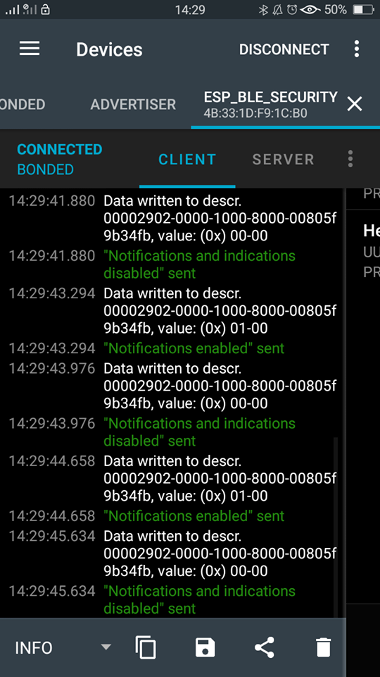

datluong
Posts: 10
Joined: Thu Jun 13, 2019 10:34 am
Postby datluong » Mon Jul 01, 2019 7:32 am
Thank you for your response,
The thing is when I try to log the error of the function:

And here is the logging file:

seen likes everything works fine but I did not receive any thing on nrf connect application on android phone :(
Here is my phone screen:

Funny thing is that, when I tried gatt_server example, the function worked. Even that I put it in call back function. Actually in the example, they put it in the call back function.
It like this:
case ESP_GATTS_WRITE_EVT: {
        ESP_LOGI(GATTS_TAG, "GATT_WRITE_EVT, conn_id %d, trans_id %d, handle %d", param->write.conn_id, param->write.trans_id, param->write.handle);
        if (!param->write.is_prep){
            ESP_LOGI(GATTS_TAG, "GATT_WRITE_EVT, value len %d, value :", param->write.len);
            esp_log_buffer_hex(GATTS_TAG, param->write.value, param->write.len);
            if (gl_profile_tab[PROFILE_A_APP_ID].descr_handle == param->write.handle && param->write.len == 2){
                    if (a_property & ESP_GATT_CHAR_PROP_BIT_NOTIFY){
                        ESP_LOGI(GATTS_TAG, "notify enable");
                        uint8_t notify_data[15];
                        for (int i = 0; i < sizeof(notify_data); ++i)
                            notify_data[i] = i%0xff;
                        //the size of notify_data[] need less than MTU size
                        esp_ble_gatts_send_indicate(gatts_if, param->write.conn_id, gl_profile_tab[PROFILE_A_APP_ID].char_handle,
                }else if (descr_value == 0x0002){
                    if (a_property & ESP_GATT_CHAR_PROP_BIT_INDICATE){
                        ESP_LOGI(GATTS_TAG, "indicate enable");
                        uint8_t indicate_data[15];
                        for (int i = 0; i < sizeof(indicate_data); ++i)
                            indicate_data[i] = i%0xff;
                        //the size of indicate_data[] need less than MTU size
                                                sizeof(indicate_data), indicate_data, true);
                else if (descr_value == 0x0000){
                    ESP_LOGI(GATTS_TAG, "notify/indicate disable ");
                }else{
                    ESP_LOGE(GATTS_TAG, "unknown descr value");
        example_write_event_env(gatts_if, &a_prepare_write_env, param);
        break;
And everything worked fine, I got the notify information in the nrf phone application:

I have fixed it, due to the different in char_handle. It should be
heart_rate_handle_table[HRS_IDX_HR_MEAS_NTF_CFG]
instead of
heart_rate_profile_tab[HEART_PROFILE_NUM].char_handle
Thank you very much.
