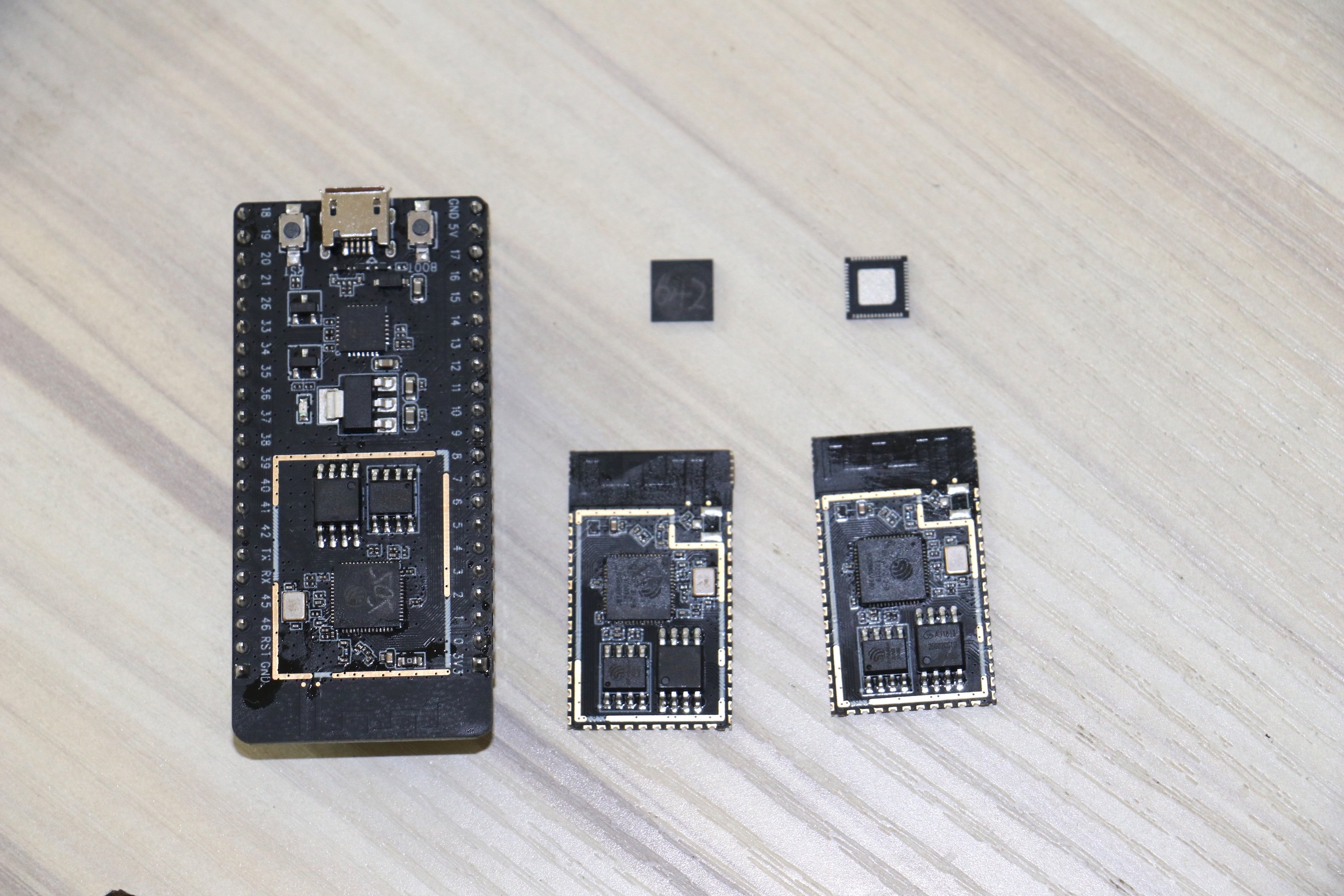

hi seon
could you already test the ESP32-S2 Beta IDF and these Toolchain with HTTP request "protocol" example / or Basic function for you?
also for interest - can you say, what (ESPRESSIF) PSRAM is soldered on the Modul / Board?
Is it 32M or 64M ( PSRAM32 / PSRAM64 )? also which SPI Flash? 32M / 64M / 128M .. ?
txs!
edit and Board pic upload:
it looks like
FLASH : 25Q32CSIG
25Q32CSIG
PSRAM: ESP-PSRAM-??
ESP-PSRAM-??
right?
it looks like
FLASH : 25Q32CSIG
PSRAM: ESP-PSRAM-??
right?
Hi Folks,
thanks widora for the infos:
again ESP32-S2 spotted in the wild
ESP32-S2-Beta-Module
more pics:

Ah...
ESP-PSRAM64_ESP-PSRAM64H_Datasheet__EN pages - esp-psram64_esp-psram64h_datasheet_en pdf.png
ESP-PSRAM64_ESP-PSRAM64H_Datasheet__EN pages - esp-psram64_esp-psram64h_datasheet_en pdf.png (17.24 KiB) Viewed 8565 times
it is ESP-PSRAM64H , it is the 3V3 Version.
datasheet :
esp-psram64_esp-psram64h_datasheet_en.pdf
(1.28 MiB) Downloaded 807 times

Hi
missing things - did i not append the pic from testings yet?
sry - now append pic from testings
pSRAM it is 3V3
@widoraIoT
txs for testing and share it
