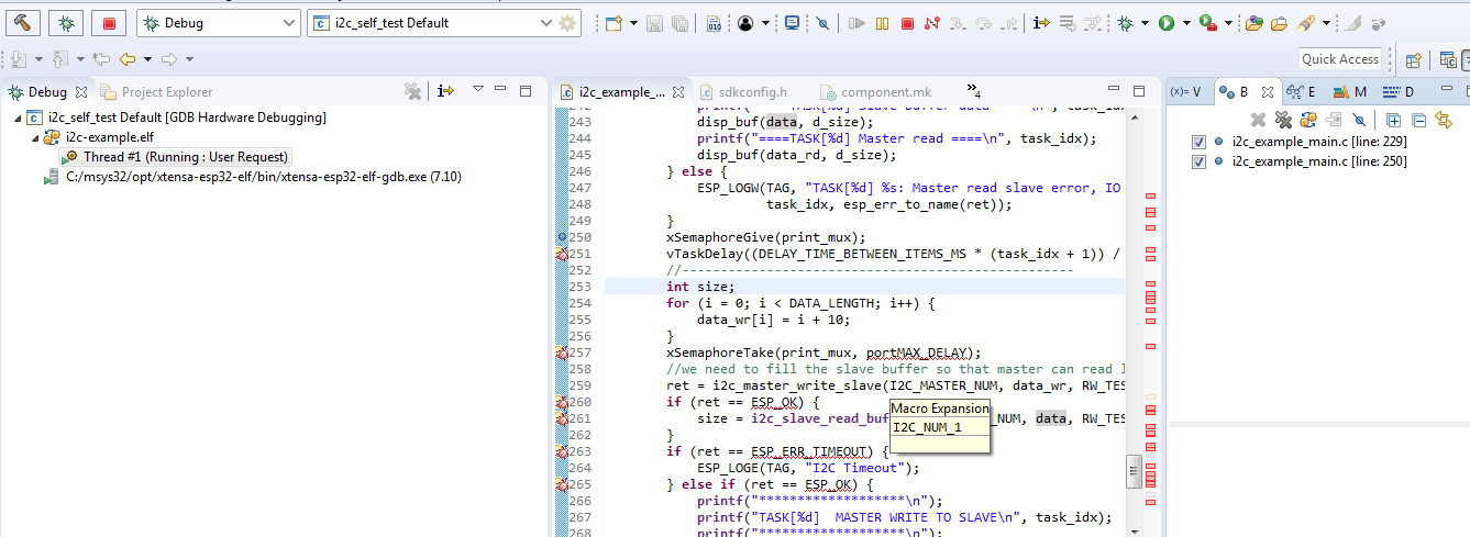

i have seleced the xtensa-esp32-elf-gdb.exe file in step 6 now when i debug on eclipse i have 2 breakpoints one in app_main() and another in the task its not stopping anywhere.

i have attached the eclipse status when debug is enabled,i am not able to see the variable in watch nor breakpoints are wroking.
so i am nor getting whether the program is starting a debug or not.
please help me in this issue,i am unable to debug the code using eclipse and wrover kit.

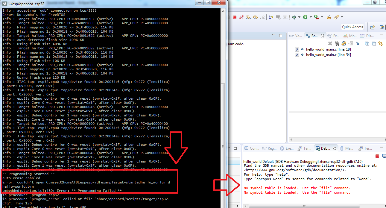

when i am pressing debug after setting all the variables and link on the command line i get some process status
in that it shows one error see the screenshot attached it is marked in red box, here it says program_esp32 faild couldnot find the path but that path is some jumbled without slash(/) and at the end its "hello_worluild" in this" hello_world" and "build" is mixed from where it taked this path or what might be the issue in this ? whereas the actual path
which contains bin file is : C:\msys32\home\ATUL\esp\esp-idf\examples\get-started\hello_world\build
and in step 8 of jtagImage debug says to add the path of bin file so i have added it as:mon program_esp32 ${workspace_loc:/hello_world/build/hello-world.bin}
my build directory location is :${workspace_loc:/hello_world}/
for rest environment variables i have attached its screenshot.
something is going wrong somwhere and i am unable to figure it out .. :(

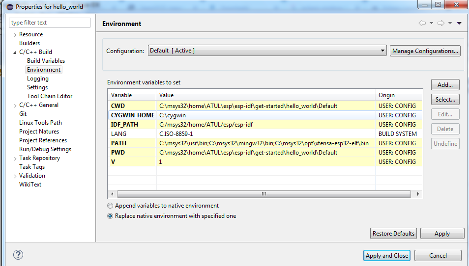

Change the "/" to "\" on IDF_PATH variable on your settings.

Hi Calin,
thanks for the kind support,actually esp-idf-tool-installer doesent work on my system may be because it supports 64 bit processor mine is 32bit i will still try do replicate what yoy did.
