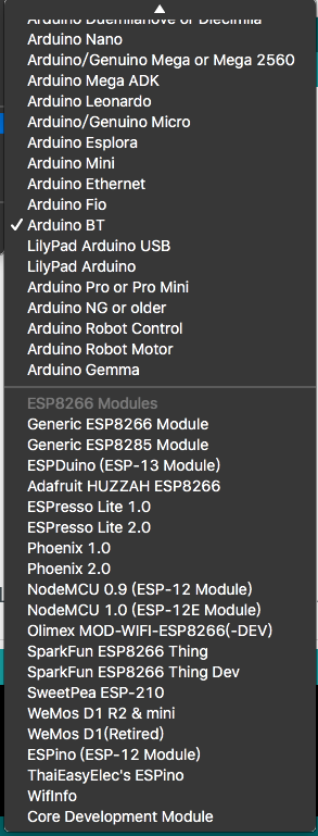

jamesliang
Joined: Fri Oct 14, 2016 2:26 am
Re: How to add ESP32 in Arduino for Mac?
Postby jamesliang » Fri Oct 21, 2016 5:30 am
first open Terminal.app
then:
mkdir -p ~/Documents/Arduino/hardware/espressif
cd /Documents/Arduino/hardware/espressif
git clone https://github.com/espressif/arduino-esp32.git esp32
cd esp32/tools
python get.py
then open/restart Arduino IDE
Thanks for your help!
I do it several times, but IDE still no show ESP32 options.
Any suggestion?
螢幕快照 2016-10-21 下午1.21.04.png (87.77 KiB) Viewed 19107 times
lakid74
Posts: 10
Joined: Mon Nov 16, 2015 8:53 pm
Postby lakid74 » Fri Oct 21, 2016 10:07 pm
It works for me...can you go into the directories you've created and type 'pwd' ?
jamesliang
Postby jamesliang » Wed Oct 26, 2016 1:49 am
Thanks a lot!
Finally it shows up.
It's my mistake to input all the code at once.
Should be run step by step. :lol:

ironsteam
Joined: Mon Dec 12, 2016 2:10 am
Postby ironsteam » Mon Dec 12, 2016 2:14 am
Hi All!
I believe line 2 with the cd should be relative to the home directory.
cd ~/Documents/Arduino/hardware/espressif
cd esp32/tools
python get.py
Cheers!
Alexandre_Ganso
Joined: Sun Feb 05, 2017 12:39 pm
Postby Alexandre_Ganso » Sun Feb 05, 2017 2:31 pm
Ok, I found it. If you have a different sketch directory in your preferences, the script will obviously not work. So, you need to check where your sketch directory is.
