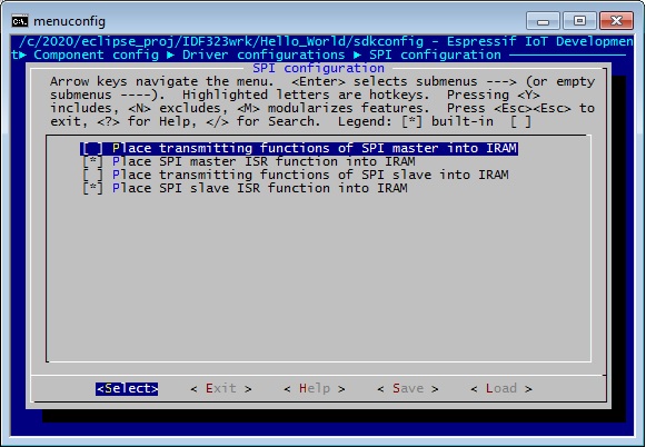

the CONFIG_ code is done by the Menuconfig automatically which you run at first to config the project by settingshi,
I'm unable to findCode: Select all
# SPI master configuration
like serial flasher , components and so on, also for specific custom things like the SPI Driver ect.
the header file is then save in the build folder under include, do not change this by hand - it is an automatically doing by Menuconfig.
you should find the SPI master configuration in menuconfig or not?
call menuconfig in your project,
go to
- Component Config
then
-Driver Configuration
then
- SPI Configuration hope this helps now.

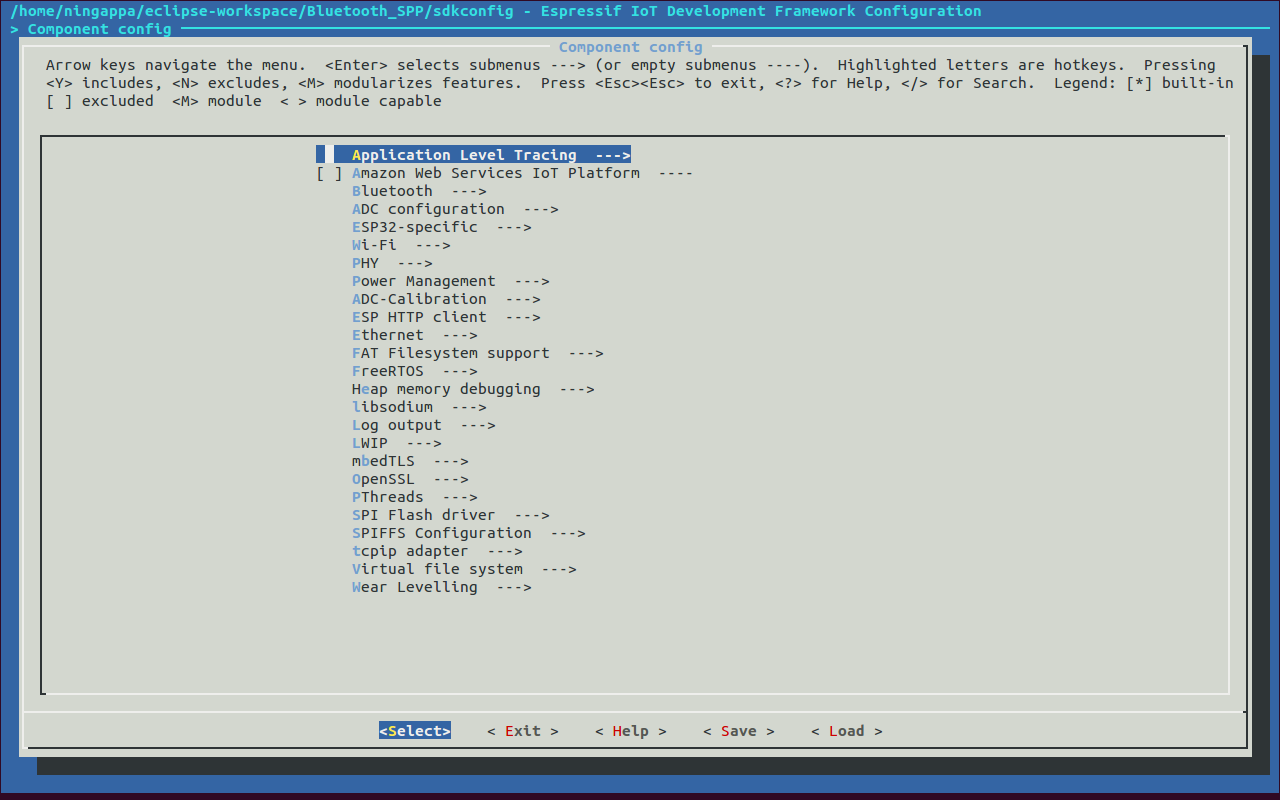

Re: Guru Meditation Error: Cache disabled but cached memory region accessed
hi,
sorry that was a toolchain version.
my menuconfig is different, those options are not showing. please check menuconfig screenshot.
- menuconfig.png (80.34 KiB) Viewed 10835 times
hi,
hi
no problem,
but what is your IDF Version
i see your screenshoot, but i think you must say , which IDF version you usemy menuconfig is different, those options are not showing. please check menuconfig screenshot.
that you can get help on your problem
txs
ningappa BS
- Posts: 51
- Joined: Sat Mar 17, 2018 4:49 am
my esp-idf version is "v3.1-dev-1334-g7cc7c8a-dirty"
could you help me on this.
