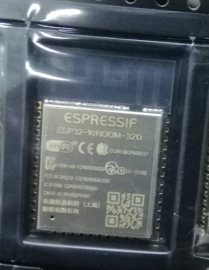

Postby vindi503 » Wed Oct 30, 2019 2:44 am
I recently order ESP32-WROOM-32D(8 MB). But after I run the software and observed it is 4MB chip. Attached chip image.
Can anyone tell me how to order a 8MB version of ESP32.
Regards,
Vinay

Postby WiFive » Wed Oct 30, 2019 2:59 am
Where did you order from? What command did you run to check flash size?

Postby vindi503 » Wed Oct 30, 2019 5:55 am
I used ESP32 Download Tool to update the new ESP32 Chip to program bootloader, partitions and Application.
I found that I had to do Clean Build my esp32 application to read size as 8MB otherwise it was showing 4MB.
