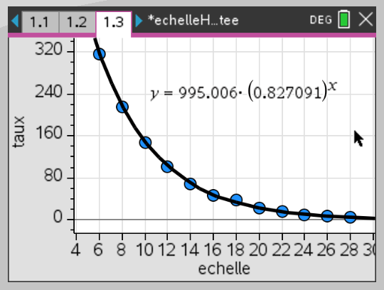

Here, they go from 1929 (damp), 2993(dry)
Another thing, as it is capacitive I doubt the readings can be mapped (map function) to a linear % gradation.
https://www.youtube.com/watch?v=pdGRs7GXBeE
I am joining a file with the formula and the curve of some tests I mage with a Mega 2560 board.
Regards
JPDaviau
echelle expo.png (59.09 KiB) Viewed 10012 times
