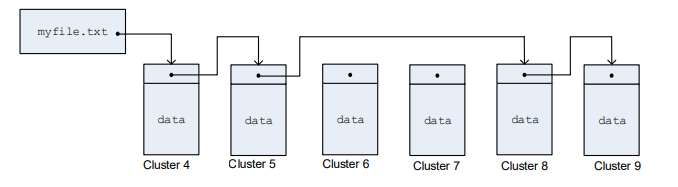

I can read raw sectors from a SD Card with sdmmc_read_sectors() fonction. But I want to read raw sectors of a specific huge file that is stored in the SD Card. But I don't know the value of his first sector ?

In fact, I want to read for example directly the cluster of myfile.txt without using POSIX/SdFat fonctions for speed. But I don't know how to know the number of the first cluster
Is there a way to read the File Allocation Table to know in which clusters the file is stored.

There doesn't seem to be a standard way (as in, POSIX) of getting the file allocation table information. FATFS library also doesn't expose any such functions, as far as I can tell. The file structure used by FATFS (called FIL) is public, though, in ff.h (https://github.com/espressif/esp-idf/bl ... #L196-L213).
C standard library functions such as fopen/fwrite don't give you a way to access the underlying FIL structure. If you use FATFS APIs (f_open, f_read, f_write) directly, then you may get the information you need from the FIL structure (FIL::clust).

In fact, I realized that clusters of a file are not necessarily following each others (in hardware).
So I couldn't read all clusters of a file with just one read command using sdmmc_read_sectors().
