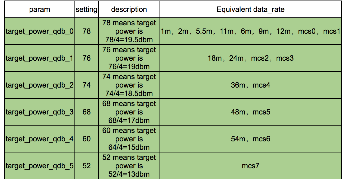

The channel power backoff configuration has 3 steps:
1) set .chan_backoff_en = 1 to enable backoff.
2) set .chanX_power_backoff. For example, setting .chanX_power_backoff=8, means setting channel x backoff to 2dB
3) Set .chanX_rate_backoff_index. Bits from low to high correspond to target_power_qdb_0 to target_power_qdb_5. For instance, when setting .chanX_rate_backoff_index=3, binary code is 00000011, it means the target_power_qdb_0 and target_power_qdb_1 have 2dB backoff.
target_power_qdb_N values correspond to data rates (table attached below).
An example:
.chan13_power_backoff=4 (backoff 1dB)
.chan13_rate_backoff_index=12 (binary code:00001100)
It means target_power_qdb_2 and target_power_qdb_3 have 1dB backoff on channel 13.
Edit: sorry, I was just informed that the above will only work with a version of PHY library more recent than what we have in ESP-IDF at this point. We'll update IDF to use latest PHY library in a few days.
