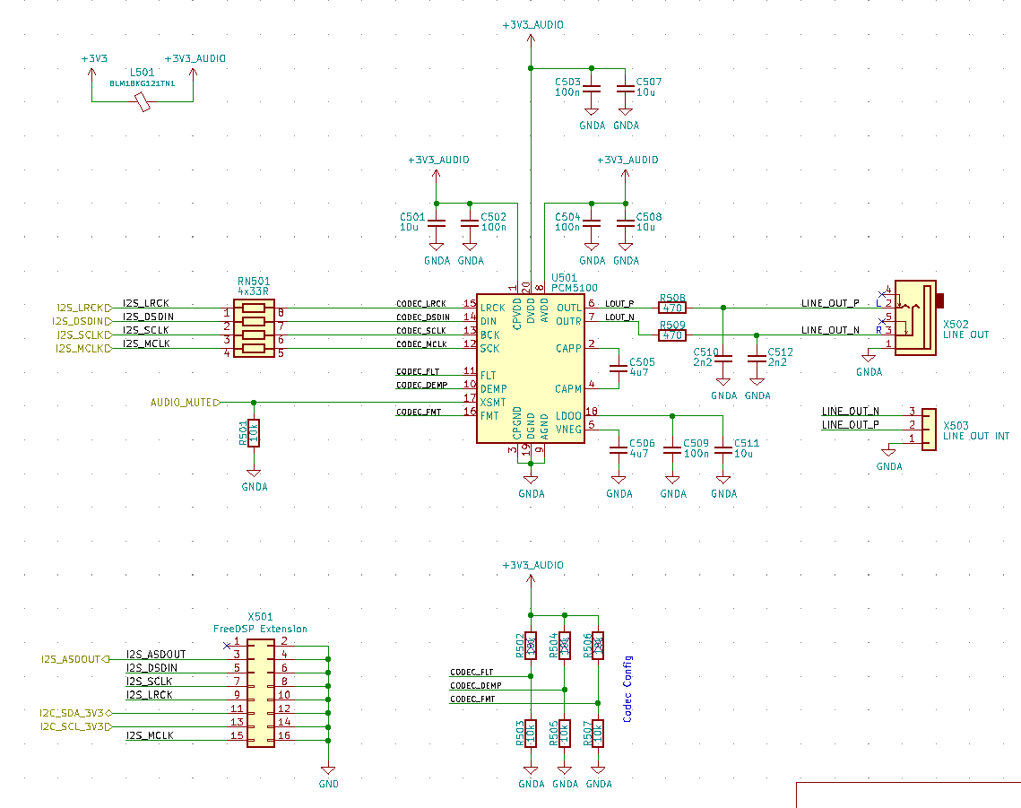

i have a project which uses the PCM5100A as I2S Audio Codec.
I currently use the bluetooth audio sink example from the esp-idf which was made for the PCM51002A.
Audio is playing fine until i increase the volume to above 80%.
If i go higher i can hear some serious distortion.
What could be the reason for that?
I am not sure if this is a hardware or software related issue.
To check that, i just ordered a PCM51002A to see if the error also occurs. (waiting for delivery)
The reason to choose the PCM5100A over the PCM51002A is to reduce BOM cost.
Here is the current schematic:
Crossed out parts (R502, R504, R506) are not mounted.
So CODEC_FLT, CODEC_DEMP and CODEC_FMT are pulled low by 10k resistors.
Thank you very much!
Kind Regards
Danie

After a bit of research i was able to fix the problem.
Maybe someone is facing a similar issue.
The clue was to set the communication_format to I2S_COMM_FORMAT_I2S in the i2s config struct:
i2s_config_t i2s_config = {
.mode = I2S_MODE_MASTER | I2S_MODE_TX, // Only TX
.sample_rate = 44100,
.bits_per_sample = 32,
.channel_format = I2S_CHANNEL_FMT_RIGHT_LEFT, // 2-channels
.communication_format = I2S_COMM_FORMAT_I2S | I2S_COMM_FORMAT_I2S_MSB,
.dma_buf_count = 6,
.dma_buf_len = 60,
.intr_alloc_flags = 0, // Default interrupt priority
.tx_desc_auto_clear = true, // Auto clear tx descriptor on underflow
.use_apll = 1
i2s_driver_install(0, &i2s_config, 0, NULL);
With this settings - audio works as expected without any distortion.
