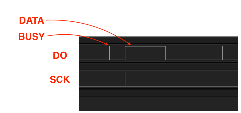

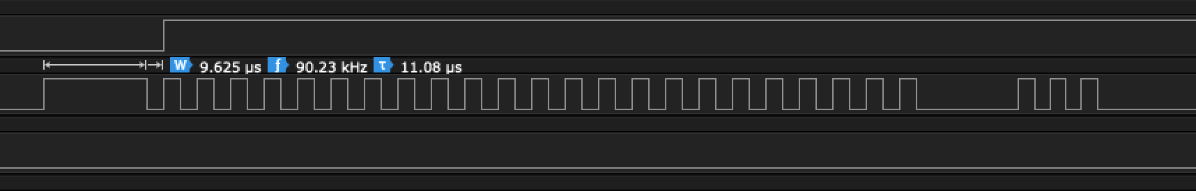

Hi guys!
I'm trying to make a floor scales based on ESP32 + HX711 and ESP-IDF over HTTP protocol.
This library https://github.com/UncleRus/esp-idf-lib ... 11/hx711.c was used for communication.
Sensors were connected in such way:
But my HX711 returns 8388607 constantly.
Here is my samples from logic analyser:
I even tried to change gain to HX711_GAIN_A_64 but it has no effect.
What can be wrong with that?
