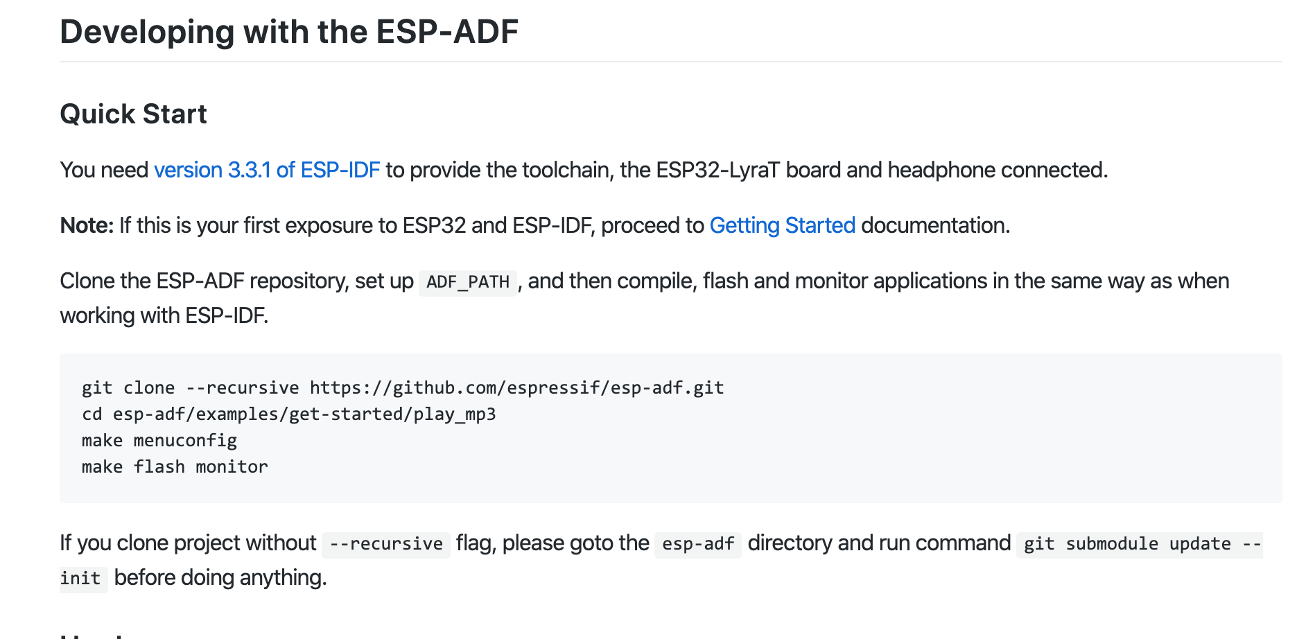

Het guys!
I thought I'd finally got my environment setup properly for building projects with my Lyra-TD MSC board, but when I try to build the first demo project, it fails.
I'm running on a CentOS7 box (headless, not VM). I install ESP-ADF, ESP-IDF, Toolchain for Linux, updated my CMake to 3.6, ran the install.sh file to make sure everything was correctly pointing to gcc 8.2 (tried the 5.2 version also but different errors), and source the export.sh file in my bash profile.
Here is the output of idf.py build:
[paul.allsopp@digitalpig play_mp3]$ idf.py build
Checking Python dependencies...

CMake Warning at /home/paul.allsopp/esp/esp-adf/esp-idf/tools/cmake/crosstool_version_check.cmake:8 (message):
Xtensa toolchain
/home/paul.allsopp/.espressif/tools/xtensa-esp32-elf/esp-2019r2-8.2.0/xtensa-esp32-elf/bin/xtensa-esp32-elf-gcc
version 8.2.0 is not the supported version 5.2.0. Check Getting Started
documentation or proceed at own risk.

[ 1%] Building C object esp-idf/xtensa-debug-module/CMakeFiles/idf_component_xtensa-debug-module.dir/eri.c.obj
xtensa-esp32-elf-gcc: error: unrecognized command line option '-mlongcalls -Wno-frame-address'; did you mean '--warn-no-frame-address'?

I've had this board now for months and haven't been able to do anything with it, which is very frustrating.
I originally tried building on my Windows 10 machine as that's where I do most of my development, but that was all kinds of pain and nonsense, hence the CentOS7 machine.
ANY help here would be very greatly appreciated. I'd like to integrate this into my home automation project, but at this point it's just another ESP32.
Thanks in advance (hopefully)!
Paul

Wow! It's like magic...
So I switched back to gcc 5.2.0 and was then told python requirements were not met and to run the install.sh script (which I have done many time already). So did that, re-sourced the export script, and now I get no errors until I get to 88% when the error points to libsodium...This is progress!
Have the guys at espressif never heard of Docker? Imagine a Docker build with all the tools included, then it wouldn't matter whether you run it on Windows/Linux/Mac...I know cause I use Docker everyday at work. OK, enough soapbox!
Onwards...hopefully.
Please feel free to let me know any gotchas, or known issues as I'm new to esp32 dev other than basic stuff on an esp8266 via Arduino.

I noticed after ensuring I had the static libsodium library, and running idf.py build, I got a little further. Then I ran idf.py build again, without making any changes, a number of times and managed to get some additional modules built, up to 94% complete but then I hit some hard errors and couldn't get any further.
So my current issue is this:

/home/paul.allsopp/esp/esp-adf/components/esp_peripherals/esp_peripherals.c:145:30: error: 'ESP_INTR_FLAG_LEVEL1' undeclared (first use in this function); did you mean 'ESP_LOG_LEVEL'?
gpio_install_isr_service(ESP_INTR_FLAG_LEVEL1);
/home/paul.allsopp/esp/esp-adf/components/esp_peripherals/lib/touch/touch.c:110:22: error: implicit declaration of function 'touch_pad_init' [-Werror=implicit-function-declaration]
bool _success = (touch_pad_init() == ESP_OK);
I think you used IDF master or v4.0 version. Please note that ADF only support IDF ver3.3 release branch.
Thanks.

Thanks Jason.
I started over completely and then went step-by-step and followed the instructions exactly. This time all went well, and I was able to test out the audio framework as intended.
Somewhere along the way previously, I had install esp-idf, esp-adf, and esp-va-sdk in one hit instead of installing and testing each one, and I must have messed something up.
All is well now, so onto the va-sdk!
