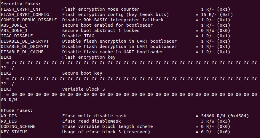

I wonder if my eFuse configuration is affecting the write speed somehow? I'll attach a screenshot.
