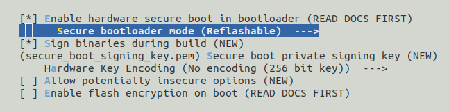

Hi All,
I tried enabling hardware secure boot in esp32 and but when I flashed bootloader, app-image, and partition table in esp32 then my device does not boot properly. Find the attachment of the esp32 booting log.
Note:- I have followed the esp32 standard procedure show below link.

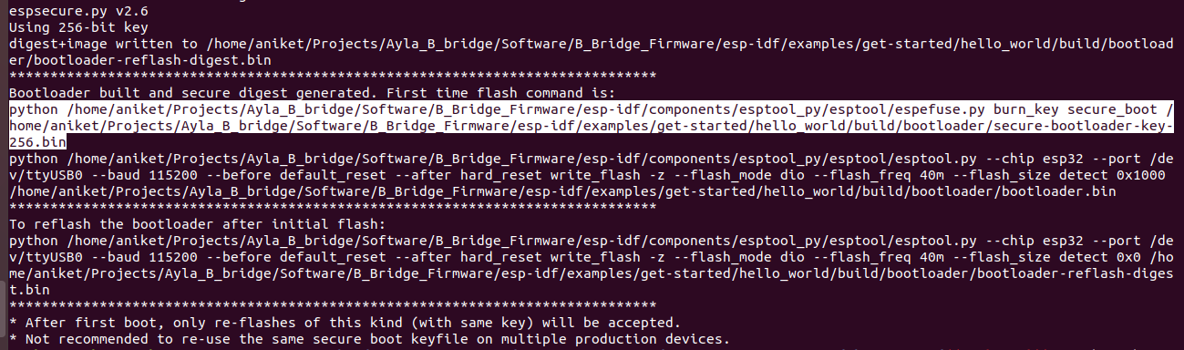

Secure boot-loader image
Screenshot from 2020-02-19 11-58-28 (copy).png (90.83 KiB) Viewed 6294 times
Enable hardware secure boot in esp32 make menuconfig
Screenshot from 2020-02-24 18-15-12.png (32.25 KiB) Viewed 6294 times

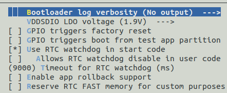

Boot-loader log level changed
Screenshot from 2020-02-25 12-46-05.png (23.59 KiB) Viewed 6227 times

Thanks for the provided support. My issue has been resolved with the use of the "espefuse.py burn_efuse ABS_DONE_0" command to enable the "secure boot enabled for bootloader" feature.

I'm glad you've resolved the problem. I'm not sure why you needed to burn this efuse manually, but it seems that reflashing with the bootloader digest file afterwards has solved the issue.
If you find yourself in a similar situation again, I suggest checking if the bootloader.bin is still too large to fit in 0x8000 bytes (offset 0x1000 to 0x9000), this can happen in which case we recommend changing the offset to 0x10000. However with all bootloader logging off, you should be fine (suggest trying Error level logging if possible, in case there is some other problem in future).
