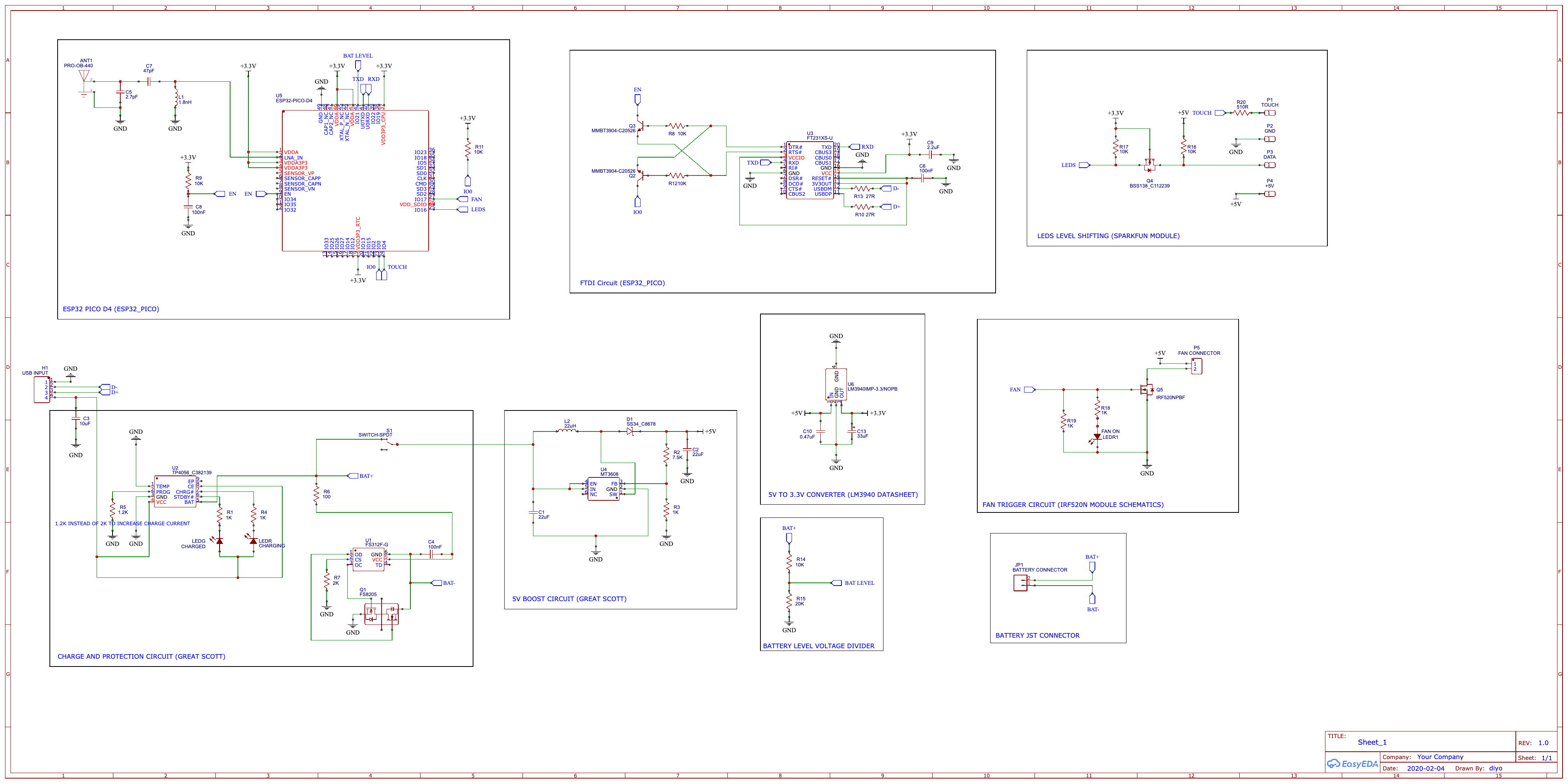

I designed a board based on different circuits available online and I just received my assembled board but I'm not able to program the ESP Pico D4 module. The USB connection is successfully made with my computer but I get a timeout error when trying to flash the module with ESPIDF.
This is what I checked for now :
  • All the connections seems to be OK, the only one I couldn't check is the ground connection below the module. I only did one small via to ground before I saw that ESP Pico Kit had several vias to connect the module to ground. Is it possible to check that module is connected to ground ?
  • All pins requiring 3.3V are connected to 3.3V.
  • IO0 and EN pins seems to be triggered correctly by the USB-UART module. (Quick check with an oscilloscope)
Am I suppose to see something on TX pin when I turn on power supply ? (I think i've read somewhere that the module sent messages at startup). This is my first real PCB project so any help would be greatly appreciated :)
You can find the schematics attached.
Thanks a lot !

Nothing jumped out at me besides the fact that you seriously need to put 0.1uf bypass caps on every power pin.
Maybe someone else catches something.

Thanks a lot ! Can this lack of bypass caps cause the module not to boot up ? Also, is there any way to verify that my module is grounded or not ?
Its hard to say every design and PCB is different.
I can't think of any with all the parts on the board. If the the ESP32 was the only part on the board you could use a multi meter in diode check mode across +3.3v and Gnd pin and you should see something other than a open circuit.
Did you poke the TX/RX pins with a scope to see if you see anything ?
Yep, 3.3V on both pins, nothing happens on TX but when I try to flash the module, I can see signal on RX pin...

Exactly the same problem i have on my custom board.
viewtopic.php?f=12&t=14549
Did you also received the board recently from JLPCB?
Maybe is a faulty lot of ESP32 PICO D4.

Yes, my board has also been printed and assembled by JLCPCB... Did you try to contact them ? I'll send them a message now to check with them...
